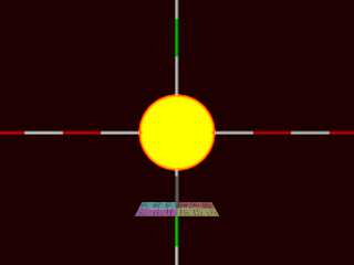

Hi all,
whilst changing an old scene to work under 3.7 I found a funny.
Have narrowed it down to the following.
using following code all is well and as expected, however if you change
the position of the plane to +2 you lose the sphere ???
Am puzzled as to why.
Can use workaround of making image_map with negative plane and then
rotate it 180*y
Is probably my understanding of things
			... Bob
plane {
   z, -2
   texture {
     pigment {
       image_map {
         png "test.png"
         interpolate 2 // smooth it
         once   // don't tile image, just one copy
       // transform it to unit-size (-1 to +1)
       translate -0.5*(x+y) // center on the origin
       scale 2              // make it unit-sized
     finish { ambient 0.3 }
sphere { 0,1 pigment { rgbt 1 }  hollow                    //
transparent sphere containing media
                              interior  { media { emission 20
                              density  { spherical density_map {
                                         [ 0 color rgbt <1, 0, 0,  1> ]
                                         [ 1 color rgbt <.9, 1, 0, -1> ] }
Download 'p1_nbg.png' (5 KB) Download 'p1_ok.png' (6 KB)

   Because planes do have an interior too. You must make it hollow when
the media is inside (below) the plane.

Hi Jaime,
many thanks for that.
I had always thought of a plane as like a piece of thin paper and the
"inside/outside" as more of a consistency thing with other objects.
			... cheers Bob

The plane have an interior. You must make it hollow or use the inverse
option.
By the way, a disk object share the same interior as a coincident plane,
and can affect nedias in the same way, outside of it's visible part.
A plane is a shape of infinite volume. One side is the inside, and
the other side is the outside.
If you eg. make a cube as an intersection of six planes (with their
normal vectors all pointing out of the cube), it will be a solid
shape, just like a box (in the sense that povray considers "solid";
ie. it can be used in CSG, and it won't contain media/fog by default).
                                                          - Warp
