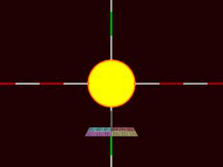

whilst changing an old scene to work under 3.7 I found a funny.
Have narrowed it down to the following.
using following code all is well and as expected, however if you change
the position of the plane to +2 you lose the sphere ???
Am puzzled as to why.
Can use workaround of making image_map with negative plane and then
rotate it 180*y
Is probably my understanding of things
			... Bob

   Because planes do have an interior too. You must make it hollow when
the media is inside (below) the plane.
jaime

Hi Jaime,
many thanks for that.
I had always thought of a plane as like a piece of thin paper and the
"inside/outside" as more of a consistency thing with other objects.
			... cheers Bob

The plane have an interior. You must make it hollow or use the inverse
option.
By the way, a disk object share the same interior as a coincident plane,
and can affect nedias in the same way, outside of it's visible part.
A plane is a shape of infinite volume. One side is the inside, and
the other side is the outside.
If you eg. make a cube as an intersection of six planes (with their
normal vectors all pointing out of the cube), it will be a solid
shape, just like a box (in the sense that povray considers "solid";
ie. it can be used in CSG, and it won't contain media/fog by default).
