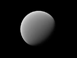

	That is correct. If you push this to the extreme, you'll get this
image (10 samples):
http://jeberger.free.fr/mpov/sphere_bl.png
	Increasing the number of samples (to 200) gives this one:
http://jeberger.free.fr/mpov/sphere_no.png

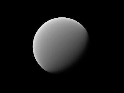

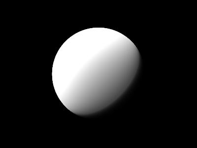

Yep, try this (povray 3.6.1, custom compile):
camera { location <0, 0, -10> look_at 0 }
light_source { <-20, 20, -20>, rgb 1 }
sphere {
  0, 3
  hollow
  pigment { color transmit 1 }
  interior {
    media {
      scattering { 5, rgb 3 }
      method 3
      intervals 1
      samples 10 // try also with 200
I've attached two images: "test1" has samples 10, "test2" has samples 200.

In my experiments, I did not see any significant difference in the output by
fiddling with aa. According to your explanation, "samples 10 aa_level 8
aa_threshold 0.0001" should give similar results to "samples 160 aa_level 4
aa_threshold 0.0001", and I don't see that with the above example. Could
you give a more clear example?
> Note that this only applies to subsurface scattering simulations: eg
> in cases when you have a very dense nearly uniform media.
Yes, my experiments are confined to uniform media. I wonder if this adaptive
sampling and antialiasing is only valid for non-uniform media (opposite to
your sentence above), maybe uniform media makes adaptive sampling
unnecessary...
Or maybe I'm making some mistakes.
light_source{9+9*x,1}camera{orthographic look_at(1-y)/4angle 30location
9/4-z*4}light_source{-9*z,1}union{box{.9-z.1+x clipped_by{plane{2+y-4*x
0}}}box{z-y-.1.1+z}box{-.1.1+x}box{.1z-.1}pigment{rgb<.8.2,1>}}//Jellby
Download 'test1.jpg' (3 KB) Download 'test2.jpg' (3 KB)
Preview of image 'test1.jpg'
Preview of image 'test2.jpg'
