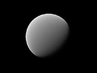

From: "Jérôme M. Berger"
Subject: Re: Media, Intervals, samples and getting results
Date: 3 Jan 2005 17:29:02
Message: <41d9c72e$1@news.povray.org>
Hash: SHA1
Jellby wrote:
| According to this, more samples -> brighter media.
	That is correct. If you push this to the extreme, you'll get this
image (10 samples):
http://jeberger.free.fr/mpov/sphere_bl.png
	Increasing the number of samples (to 200) gives this one:
http://jeberger.free.fr/mpov/sphere_no.png
| But I see the opposite,
| as if the influence of the samples was "averaged" (since most
samples are
| deep inside, the effect of the surface ones is weaker). I would have
| thought that the sampling algorithm (and colour calculation) would be
| smarter than that, but maybe that's not so easy...
	Do you have a sample code that produces this effect?
|>BTW, you
|>shouldn't increase the number of samples too much. Instead you should
|>increase the aa_level and possibly decrease the aa_threshold. This
|>will ensure that the additional samples get taken in places where
|>they will have a useful impact on the result.
| I couldn't get the same effect... Even if the "darkening" due to many
| samples (or intervals) is an artifact, I didn't find a reliable way
to get
| what I needed other than increasing the number of samples.
	It takes some trial and error, but it should be possible to get the
same effect with a much faster render. Of course, it all depends on
whether you can afford to waste more time fiddling with the
parameters or simply letting the computer render in the background
while you're doing something else ;) To make accurate comparisons,
you also need to make sure that the maximum number of samples is the
same in both cases (I'm not talking of the second parameter of the
"samples" keyword here, but of the number of potential samples which
is something in the order of min_samples * 2^aa_level). Then if you
set aa_threshold to 0 the results should be the same (and take
*forever* to render) so all you need to do is find a value that's low
enough to get the effect you want while not being exactly 0.

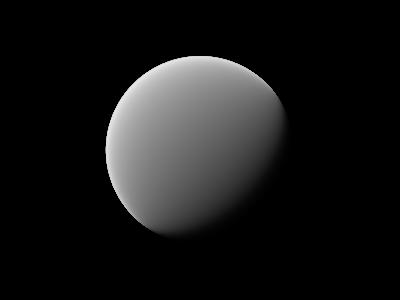

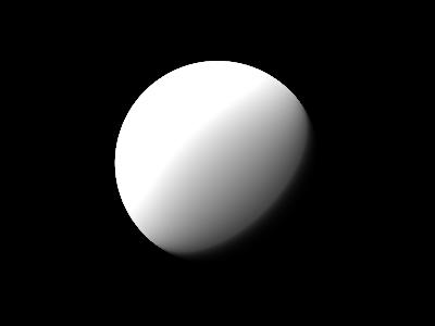

From: Jellby
Date: 3 Jan 2005 18:25:53
Message: <41d9d47f@news.povray.org>
> samples are
Yep, try this (povray 3.6.1, custom compile):
camera { location <0, 0, -10> look_at 0 }
light_source { <-20, 20, -20>, rgb 1 }
sphere {
  0, 3
  hollow
  pigment { color transmit 1 }
  interior {
    media {
      scattering { 5, rgb 3 }
      method 3
      intervals 1
      samples 10 // try also with 200
I've attached two images: "test1" has samples 10, "test2" has samples 200.

In my experiments, I did not see any significant difference in the output by
fiddling with aa. According to your explanation, "samples 10 aa_level 8
aa_threshold 0.0001" should give similar results to "samples 160 aa_level 4
aa_threshold 0.0001", and I don't see that with the above example. Could
you give a more clear example?
> Note that this only applies to subsurface scattering simulations: eg
> in cases when you have a very dense nearly uniform media.
Yes, my experiments are confined to uniform media. I wonder if this adaptive
sampling and antialiasing is only valid for non-uniform media (opposite to
your sentence above), maybe uniform media makes adaptive sampling
unnecessary...
Or maybe I'm making some mistakes.
light_source{9+9*x,1}camera{orthographic look_at(1-y)/4angle 30location
9/4-z*4}light_source{-9*z,1}union{box{.9-z.1+x clipped_by{plane{2+y-4*x
0}}}box{z-y-.1.1+z}box{-.1.1+x}box{.1z-.1}pigment{rgb<.8.2,1>}}//Jellby
Download 'test1.jpg' (3 KB) Download 'test2.jpg' (3 KB)
Preview of image 'test1.jpg'
Preview of image 'test2.jpg'
