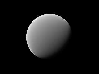

| According to this, more samples -> brighter media.
	That is correct. If you push this to the extreme, you'll get this
image (10 samples):
http://jeberger.free.fr/mpov/sphere_bl.png
	Increasing the number of samples (to 200) gives this one:
http://jeberger.free.fr/mpov/sphere_no.png
| But I see the opposite,
| as if the influence of the samples was "averaged" (since most
samples are
| deep inside, the effect of the surface ones is weaker). I would have
| thought that the sampling algorithm (and colour calculation) would be
| smarter than that, but maybe that's not so easy...
	Do you have a sample code that produces this effect?

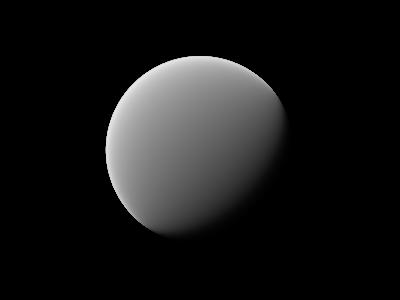

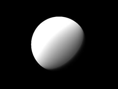

Yep, try this (povray 3.6.1, custom compile):
camera { location <0, 0, -10> look_at 0 }
light_source { <-20, 20, -20>, rgb 1 }
sphere {
  0, 3
  hollow
  pigment { color transmit 1 }
  interior {
    media {
      scattering { 5, rgb 3 }
      method 3
      intervals 1
      samples 10 // try also with 200
I've attached two images: "test1" has samples 10, "test2" has samples 200.

In my experiments, I did not see any significant difference in the output by
fiddling with aa. According to your explanation, "samples 10 aa_level 8
aa_threshold 0.0001" should give similar results to "samples 160 aa_level 4
aa_threshold 0.0001", and I don't see that with the above example. Could
you give a more clear example?
> Note that this only applies to subsurface scattering simulations: eg
> in cases when you have a very dense nearly uniform media.
Yes, my experiments are confined to uniform media. I wonder if this adaptive
sampling and antialiasing is only valid for non-uniform media (opposite to
your sentence above), maybe uniform media makes adaptive sampling
unnecessary...
Or maybe I'm making some mistakes.
