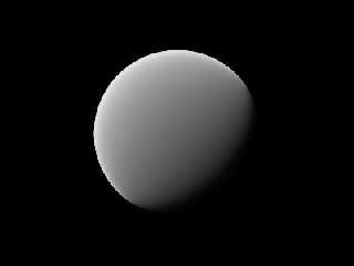

From: "Jérôme M. Berger"
Subject: Re: Media, Intervals, samples and getting results
Date: 3 Jan 2005 14:16:02
Message: <41d999f2@news.povray.org>
Hash: SHA1
Jellby wrote:
| What I don't quite understand is why the number of samples has so much
| effect over the overall brightness of the media (I'm thinking of dense
| scattering media to simulate SSS). Sure, the sample number should
affect
| the quality and presence of possible artifacts, but why is "samples
15" so
| much brighter than "samples 75" (method 3, intervals 1)? Is this
maybe due
| to some bad coding on my part?
	That's because the darkening you see is an artefact :) It's due to
the fact that when you don't take many samples, a lot of them
proportionnaly get taken deep inside the media where it's dark.
Increasing the number of samples ensures that more and more get taken
in the thin layer near the surface where the SSS effect occurs which
leads POV to notice that the result should be bright. BTW, you
shouldn't increase the number of samples too much. Instead you should
increase the aa_level and possibly decrease the aa_threshold. This
will ensure that the additional samples get taken in places where
they will have a useful impact on the result.
		Jerome

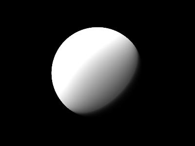

From: Jellby
Date: 3 Jan 2005 14:35:22
Message: <41d99e79@news.povray.org>
According to this, more samples -> brighter media. But I see the opposite,
as if the influence of the samples was "averaged" (since most samples are
deep inside, the effect of the surface ones is weaker). I would have
thought that the sampling algorithm (and colour calculation) would be
smarter than that, but maybe that's not so easy...
> BTW, you
I couldn't get the same effect... Even if the "darkening" due to many
samples (or intervals) is an artifact, I didn't find a reliable way to get
what I needed other than increasing the number of samples.
Date: 3 Jan 2005 17:29:02
Message: <41d9c72e$1@news.povray.org>
Hash: SHA1
	That is correct. If you push this to the extreme, you'll get this
image (10 samples):
http://jeberger.free.fr/mpov/sphere_bl.png
	Increasing the number of samples (to 200) gives this one:
http://jeberger.free.fr/mpov/sphere_no.png
samples are
	Do you have a sample code that produces this effect?

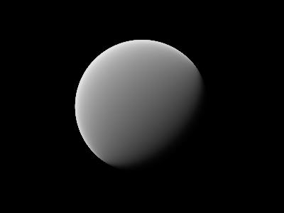

From: Jellby
Date: 3 Jan 2005 18:25:53
Message: <41d9d47f@news.povray.org>
> samples are
Yep, try this (povray 3.6.1, custom compile):
camera { location <0, 0, -10> look_at 0 }
light_source { <-20, 20, -20>, rgb 1 }
sphere {
  0, 3
  hollow
  pigment { color transmit 1 }
  interior {
    media {
      scattering { 5, rgb 3 }
      method 3
      intervals 1
      samples 10 // try also with 200
I've attached two images: "test1" has samples 10, "test2" has samples 200.

In my experiments, I did not see any significant difference in the output by
fiddling with aa. According to your explanation, "samples 10 aa_level 8
aa_threshold 0.0001" should give similar results to "samples 160 aa_level 4
aa_threshold 0.0001", and I don't see that with the above example. Could
you give a more clear example?
> Note that this only applies to subsurface scattering simulations: eg
> in cases when you have a very dense nearly uniform media.
Yes, my experiments are confined to uniform media. I wonder if this adaptive
sampling and antialiasing is only valid for non-uniform media (opposite to
your sentence above), maybe uniform media makes adaptive sampling
unnecessary...
Or maybe I'm making some mistakes.
light_source{9+9*x,1}camera{orthographic look_at(1-y)/4angle 30location
9/4-z*4}light_source{-9*z,1}union{box{.9-z.1+x clipped_by{plane{2+y-4*x
0}}}box{z-y-.1.1+z}box{-.1.1+x}box{.1z-.1}pigment{rgb<.8.2,1>}}//Jellby
Download 'test1.jpg' (3 KB) Download 'test2.jpg' (3 KB)
Preview of image 'test1.jpg'
Preview of image 'test2.jpg'
