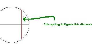

What is the formula for finding the height of a circle perpendicular to a
given point on the radius?
Thank you,
 -Shay

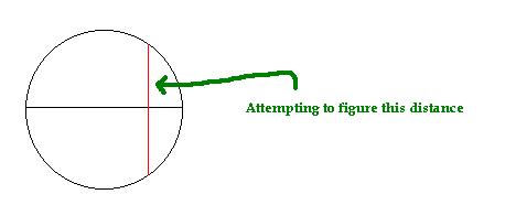

From: Shay
Subject: Re: math ?
Date: 18 Apr 2001 17:49:08
Message: <3ade0bd4@news.povray.org>
Ron Parker <ron### [at] povrayorg> wrote in message
news:slr### [at] fwicom...
> Your question doesn't make any sense.  Can you draw a picture?
> Ron Parker   http://www2.fwi.com/~parkerr/traces.html
> My opinions.  Mine.  Not anyone else's.
Download 'drawing.jpg' (8 KB)
Preview of image 'drawing.jpg'

I guess I kinda asked for that one, didn't I?  The picture should have gone
in .binaries.images, but since it's small, I won't complain too loudly.
Ah.  The picture helps.  But we also need to know what you do know.
Obviously if you knew the location of the center and the location of
the point, the answer would be trivial, so you must have something
else in mind.
So... what information do you have?
