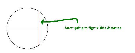

What is the formula for finding the height of a circle perpendicular to a
given point on the radius?
Thank you,
 -Shay

From: Shay
Subject: Re: math ?
Date: 18 Apr 2001 17:49:08
Message: <3ade0bd4@news.povray.org>
Ron Parker <ron### [at] povrayorg> wrote in message
news:slr### [at] fwicom...
> Your question doesn't make any sense.  Can you draw a picture?
> Ron Parker   http://www2.fwi.com/~parkerr/traces.html
> My opinions.  Mine.  Not anyone else's.
Download 'drawing.jpg' (8 KB)
Preview of image 'drawing.jpg'

I guess I kinda asked for that one, didn't I?  The picture should have gone
in .binaries.images, but since it's small, I won't complain too loudly.

Ah.  The picture helps.  But we also need to know what you do know.
Obviously if you knew the location of the center and the location of
the point, the answer would be trivial, so you must have something
else in mind.
So... what information do you have?

From: Margus Ramst
Subject: Re: math ?
Date: 18 Apr 2001 18:06:53
Message: <3ADE036B.D0945451@peak.edu.ee>
Shay wrote:
Umm... Perhaps
2*sin(acos(Distance/Radius))*Radius
where Distance is the distance of the point from the centre.
This is provided I don't get my sin and cos mixed up as per usual.
Margus Ramst

From: Shay and/or Carrie Ann
Subject: Re: math ?
Date: 18 Apr 2001 20:47:11
Message: <3ade358f@news.povray.org>
nothing more complex than that. I do know the location of the point and of
the center. This is an easy question with an easy answer, just one with
which I am not familiar. What I have in mind is an arrangement of objects
beneath a dome, but not touching it. I am going to test out Margus Ramst's
formula. I'm sure he got it right. Thank you.
     -Shay

From: Ron Parker
Subject: Re: math ?
Date: 18 Apr 2001 22:14:33
Message: <slrn9dsigc.dik.ron.parker@fwi.com>
If you know the location of the point and the location of the center, the
height is just Point.y-Center.y for a circle.  For a dome, you can use
sqrt( Radius^2 - vlength(<Point.x,Point.y,0>-<Center.x,Center.y,0>)^2 )
From: Jean-Michel Grimaldi
Subject: Re: math ?
Date: 19 Apr 2001 10:24:54
Message: <3ADEF4A7.E640ECA6@via.ecp.fr>
You're right.
Though when the sin is >0, sin(acos x) = sqrt(1-x^2).
So a prettier formula would be :
  2*sqrt(Radius^2-Distance^2)
JM
Subject: Re: math ?
Date: 21 Apr 2001 20:56:33
Message: <3AE22B4F.71CEF7A0@faricy.net>
sqrt((radius)^2 - (distance_from_center)^2)
