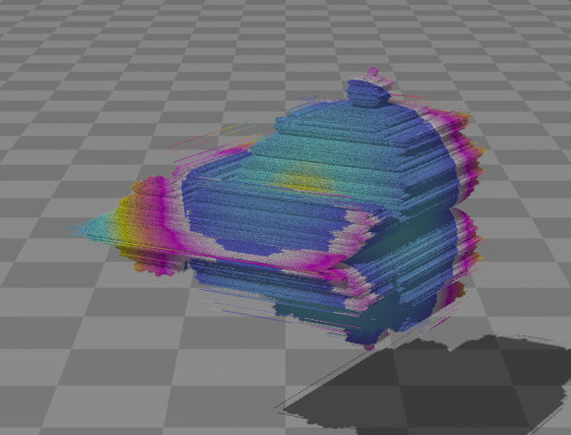

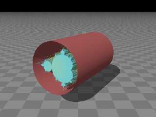

I'd expected that the areas "far outside" of the Mandelbrot set (outside
of the red cylinder) would have "low" values, so they are far "outside"
of the isosurface. But they aren't, so the result is that the whole
contained_by box is filled.
Is it a bug how mandel pattern & isosurface work together or is the bug
in my scene file? :-/
Lars R.
Download 'mandel.pov.txt' (2 KB) Download 'mandel.png' (171 KB)
Preview of image 'mandel.png'

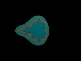

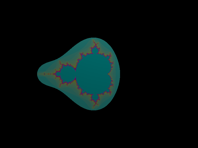

Here's the pattern with 1000 iterations on an xy plane.
Download 'mandeltest.png' (29 KB)
Preview of image 'mandeltest.png'
From: Lars Rohwedder
Subject: Re: "mandel" as function in isosurface has unexpected results
Date: 15 Dec 2022 14:30:33
Message: <639b75d9@news.povray.org>
Am 15.12.22 um 19:36 schrieb Bald Eagle:
>> Lars R.
> It looks like the pattern drops off to zero.
Correct.

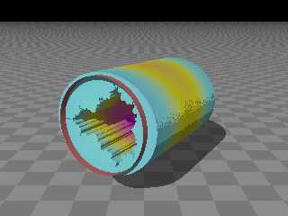

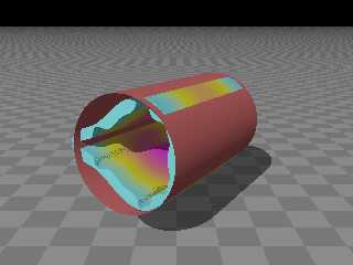

According to the documentation of isosurface, all points with function
value  < threshold are "inside" the isosurface object.
The "mandel" pattern is "low" (near zero) far away from the Mandelbrot
set, increases slowly near the border of the set and is 1 inside the
"apple shape" set itself (with default values for "interior" and "exterior".
So I had expected that a formula like 0.9 - mandel would give the
desired result:
   * the points inside the Mandelbrot set will be <0, so are consideded
as "inside" the rendered shape.
   * the points far away of the Mandelbrot set will be >0, so are
"outside" of the rendered shape.
But the rendering looks completely different than expected, see attached
Changing the formula to 0.5-mandel2(x,y,z) it looks much more than a
Mandelbrot set, but it is "inverse": the Mandelbrot set is "outside",
the surrounding areay is inside. Hence I switched the sign, so the
forumla becomes mandel(x,y,z)-0.5.
So the inside of the Mandelbrot set becomes the inside of the
isosurface, as expected, but also the far away areas are "inside", which
is _not_ what I expected.
What went wrong here?
Lars R.
pS: The "open" keyword just removes the visibility of the contained_by
object, but I consider it helpful to see what is insided and what it is
outside of the isosurface object.
Download 'mandel-0.5.png' (25 KB) Download 'mandel-0.9.png' (20 KB)
Preview of image 'mandel-0.5.png'
Preview of image 'mandel-0.9.png'

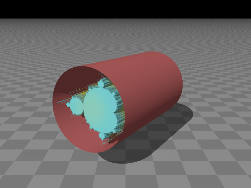

Subject: [solved] "mandel" as function in isosurface has unexpected results
Date: 16 Dec 2022 02:27:29
Message: <639c1de1@news.povray.org>
>> function value  < threshold are "inside" the isosurface object.
> Wellll...... it's an isoSURFACE, so there really is no inside, unless
> (IIRC) for csg you use all_intesections
>> Mandelbrot set, increases slowly near the border of the set and is
>> 1 inside the "apple shape" set itself (with default values for
> Can you cite that with a link, or is that your working hypothesis?
https://www.povray.org/documentation/view/3.6.1/377/
See the explanations for "interior" and "exterior" types 0 and 1.
A default color map is not mentioned there at all, hence I did not know
about that. :-/
> Part of what's going wrong is that mandel is a POV-Ray pattern that
> has a built in color map.   And that wreaks hell with everything
> right from the beginning.
I see. It should be mentioned in the documentation of the mandel
pattern. :-/
> I'd say try using:
> #declare Mandel = function { pigment {mandel 1000 exterior 1, 1
> color_map {[0 rgb 0] [1 rgb 1]}}}
> But you're having more success than I am.

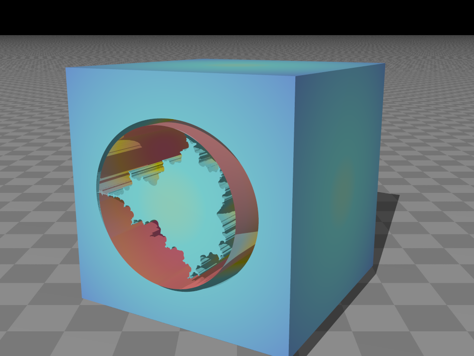

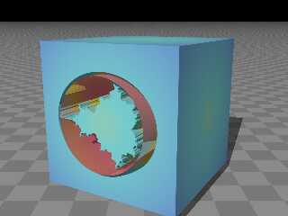

Thank you a lot! Changing the color map into a stupid black-to-white
ramp solves the problem.
See attached .pov files and renderings.
> Maybe you post your full scene as an attachment, and someone can
> figure this out.
I did it in my original posting.
Thanks again and enjoy the renderings (or use them as inspirations for
own "weird christmas tree" ideas. ;-)
Lars R.
Download 'mandel.pov.txt' (2 KB) Download 'mandel.png' (145 KB) Download 'mandel2.pov.txt' (2 KB) Download 'mandel2.png' (201 KB)
Preview of image 'mandel2.png'

    #declare MandelFn = function { pattern { mandel 1000 } };
    plane {
        +z, 0
        pigment {
            function { MandelFn(x, y, z) }
            color_map {
                [ 0.0 color rgb <0, 0, 0> ]
                [ 0.2 color rgb <1, 0, 0> ]
                [ 0.4 color rgb <1, 1, 0> ]
                [ 1.0 color rgb <1, 1, 1> ]
                [ 1.0 color rgb <0, 0, 0> ]
