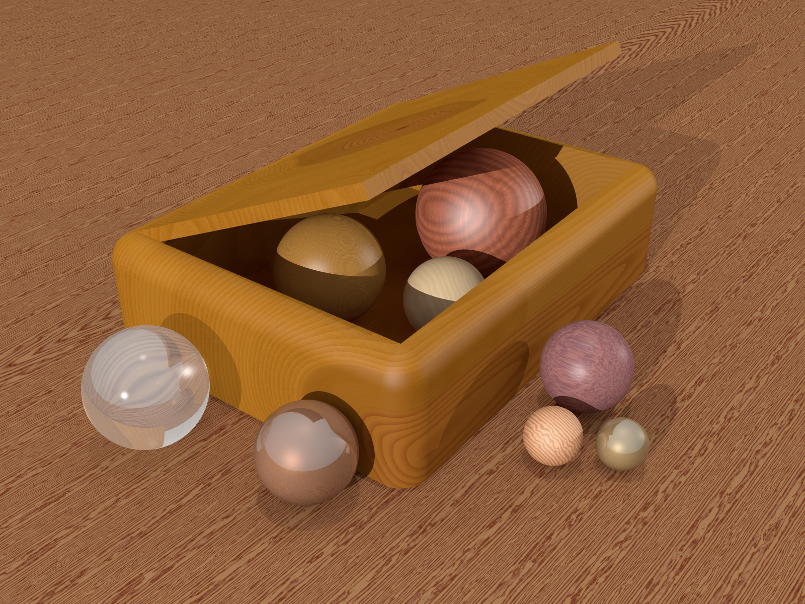

From: And
Subject: Re: Wood program but still develop
Date: 3 Jun 2022 08:30:01
Message: <web.6299fd915b6ed24c11d6faaaa81652d@news.povray.org>
"jr" <cre### [at] gmailcom> wrote:
> hi,
> "And" <49341109@ntnu.edu.tw> wrote:
> > Now I know it does not finish yet.
> do you always do "blocks", or have you put the texture to use yet?  (thinking,
> eg, the distribution 'woodbox.pov' scene, or such)
> regards, jr.

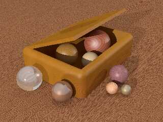

After investigate colors from photo. put them together reluctantly.
I apply this yellow color wood to woodbox.pov, only the container.
Download 'woodbox test.png' (3516 KB)
Preview of image 'woodbox test.png'

From: jr
Date: 5 Jun 2022 04:40:00
Message: <web.629c6b455b6ed242119a36b6cde94f1@news.povray.org>
hi,
glad you did.  the pattern looks sumptuous, in particular I'm impressed by just
how believable the texture looks, the graining on the narrow side of the lid is
... wow.
regards, jr.

Thank you.
I like this admix, too.

I imitate that box color and direct of pattern by this one (But the color is
selected by photos of mine) which the texture is scanned.
https://www.turbosquid.com/3d-models/scanned-objects-3d-model-1694388
There are too many details to imitate, but the color changing at the corner is
catch my eye. I know that proximity pattern discussed in the newsgroups.
http://news.povray.org/povray.binaries.images/thread/%3Cweb.4bda394e8fe449e421619a220%40news.povray.org%3E/

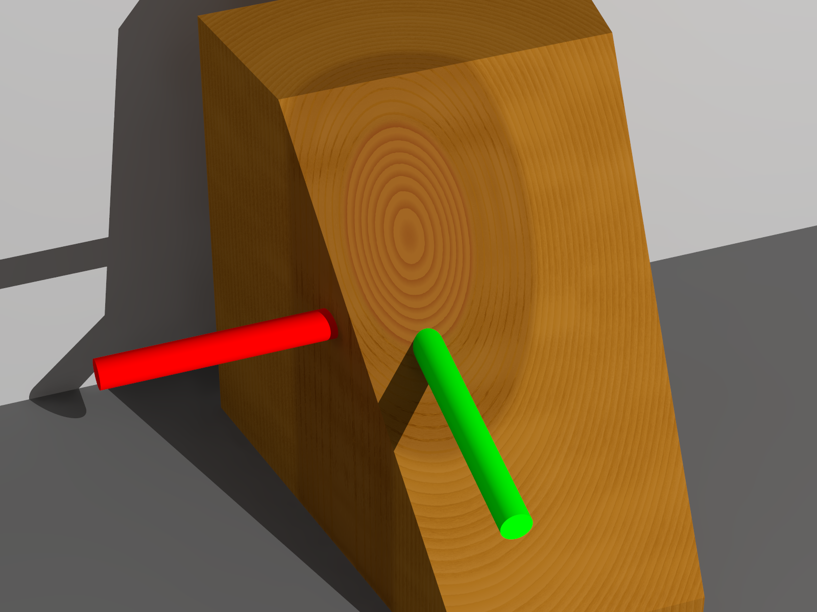

I have completed most of the arrangement of output .inc files.
All effects remains the previous.
In fact, I doubt about the albedo of the (selected) color.
1). I knows that the albedo of many substances are between 0.0.. ~ 0.6...(60%),
the white wall or white paper is just about 60%. The correct value of the albedo
cannot measure from the photograph directly, unless you know the light source
strength.
2). The rendered image shows the current composite of patterns. Include the
fiber and big color block. It takes 20m46s to render.
3). I have fixed and eliminated the discontinuous line on the angle terminal
position.
4). The variance of the pattern is not enough for the z(height) direct. If you
cut this pattern using a cylinder, or just the "rotary peeled" method. The
result pattern will very unnatural.
Download 'show tree function.png' (1013 KB)
Preview of image 'show tree function.png'
