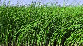

Attached is my code. You have all latitude to make changes, experiment,
or expand.
Enjoy!
Download 'wind_pattern.zip' (75 KB)

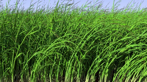

In the console there are a lot of lines:
File '/usr/share/povray-3.7/include/math.inc' line 232: Possible Parse Error:
Normalizing zero-length vector.
But, the render started.
Interesting work! :)
Download 'wind_pattern.jpg' (86 KB)
Preview of image 'wind_pattern.jpg'
I know but I don't know what to do about that. As far as I know I have
dealt with all zero-length vectors.
Anyway, they have no effect on the render.
Thanks! :-)

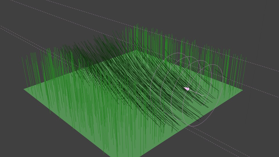

But, I had an idea to use means of Blender (force field : wind) to do without
excess mathematical calculations.
Wind is applied to particles, but there is no realistic bend
It is necessary to find only the solution of a realistic bend of a trunk of a
plant also means of Blender
Download 'force_field_wind.jpg' (99 KB)
Preview of image 'force_field_wind.jpg'
