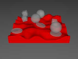

From: Chris R
Subject: Re: Object Placement Rabbit Hole
Date: 6 Aug 2025 13:45:00
Message: <web.6893945bcdb86248bdf5e0875cc1b6e@news.povray.org>
"Chris R" <car### [at] comcastnet> wrote:
> > > I wrote the code based on the letter stacking code in libcollide.inc and
> > > debugged it, and added the grid generation piece to my libmesh.inc library.
> > > Here are the results of repeatedly adding 20 discs to the same uneven surface
> > > using the algorithm.  I think it does pretty well and it's actually quick enough
> > > that you could run it during rendering, but I kept the option to write the
> > > transforms to a file so you can pre-create them.
> > Damn, that is nice.
> > I'm hoping to see a pile of many more primitives on a much more uneven surface!
> > Nice work!
> > - BW
> Coming Real Soon Now...
> I plan to add documentation to the library code files and create a usable sample
> scene using them as an example.  In the mean time, I can create a version of
> this scene with additional object types and I can pervert the surface as well.
> -- Chris R
Documentation, official sample scene, and posting of references to the GitHub
repo for this code are still TBD, but here is another sample after some updates
to the code.
The original author had code that would verify the difference between the 3
found support points and the surface beneath them are within a given threshold.
After staring at the code for a long time, I believe the first two contact
points should always end up directly on the surface, but it's possible the 3rd
one could be off due to the distance estimation from the surface being a linear
projection onto the X-Z plane, but the transformation is a rotation, which means
the final object point gets rotated onto the plane, not projected.
To cover this, the author, for his scene, would check the distance and would
jitter the object a bit if it was too large and then try again.
In my code, the layout only makes one attempt, but I return the 3 resting points
for the object and the surface as part of the transformation result.  In my test
code, I check to see if the max distance is higher than my threshold and do the
jitter of the object there to get a better position.
The results are pretty good, even with the bumpier surface I am using now.
Resting spheres on each other still results in unstable-looking structures,
(unless the spheres are covered with super-glue...)
I will get to work cleaning and documenting and let you know where you can find
the code and how to use it.
-- Chris R

From: Chris R
Date: 7 Aug 2025 10:30:00
Message: <web.6894b79ecdb86248239175245cc1b6e@news.povray.org>
enough
> > > Damn, that is nice.
> > > Nice work!
> > > - BW
> > -- Chris R
> to the code.
> -- Chris R
Last update in this thread.  I added documentation and an example .pov file
using the new macro and committed the code to:
https://github.com/carath63/povlibrary
Given the way I write code, you will end up needing a lot of the files in the
library folder, so just check out the whole thing from GitHub.  The relevant
files to look at for this are:
1. Examples/collision_grid_test.pov
2. library/libmesh.inc
3. library/libcollide.inc
The two main new macros are:
1. Mesh_grid_surface_create - for scanning an object and creating a mesh of
points for its top or bottom surface.
2. Col_rest_grid_on_surface_transform - for taking the grid created by
Mesh_grid_surface_create and finding a transformation that rests it on a surface
object.
A couple of notes: The result of calling Col_rest_grid_on_surface_transform is a
dictionary representation of an SDL transform.  The code for creating and
interpreting this dictionary is in library/libstringify.inc.  The macro adds an
additional entry to the dictionary containing the 3 points on the object and the
3 points on the surface that were used to create the transformation.  This is
what I use to nudge the object around the surface if the transform does not
result in all three points touching the surface.
-- Chris R
