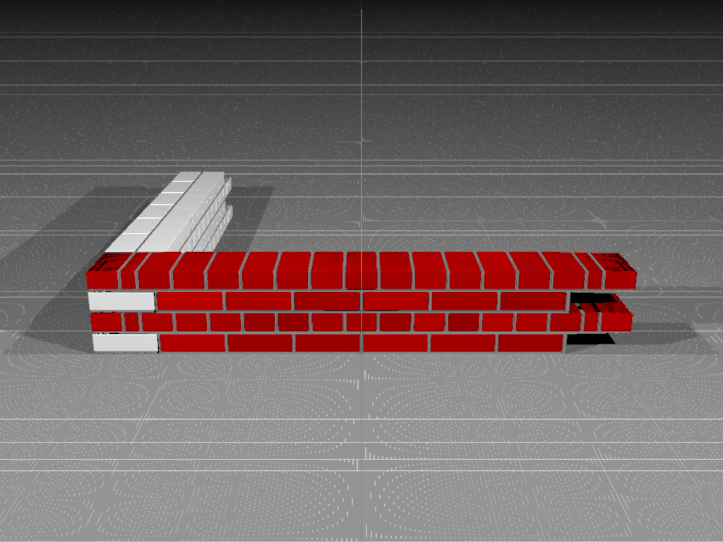

Since my first post on starting a bricks library, I have rewritten the code
about 3 times, but I think I'm pretty happy with the system I've created.  The
code for doing the layouts isn't ready for prime-time yet, and even the sample
scenes are pretty verbose because there aren't a lot of default behaviors built
into the system yet.
Anyway, this first image is a pretty simple stretcher-bond wall of 2-half-brick
thickness with jagged ends for making a corner, (which you probably wouldn't do
with a 2-half-brick wall, but anyway...)
I'll follow up with a corner example, and an English bond wall if 3-half-bricks.
For all of these, the mortar is a block with the brick shapes subtracted out,
but I have created a system for specifying mortar joint specifications.  In the
two images where I have laid the mortar, I am using a grapevine joint for all of
the mortar regions.  You can specify different joints for the horizontal,
vertical, and face mortar sections, and I have defined all 9 of the primary
joint types.
-- Chris R.
-- Happily rendering since 2014
Download 'stretcher_bond.png.png' (201 KB)
Preview of image 'stretcher_bond.png.png'

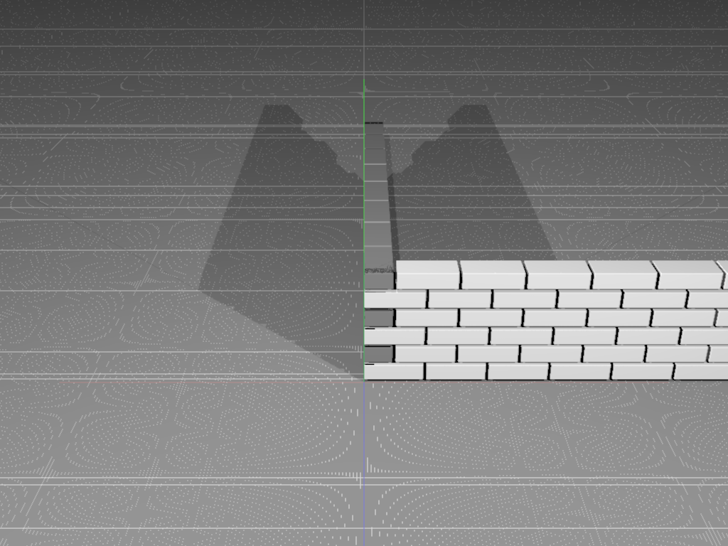

From: Chris R
Subject: Re: Bricks library updates
Date: 3 Jan 2024 13:50:00
Message: <web.6595ac2a992755548a3c0aee5cc1b6e@news.povray.org>
This is a wall corner consisting of two stretcher-bond walls with different
parity and their left/right ends created to support a corner.  In this example I
did not add the mortar.
-- Chris R.
Download 'stretcher_bond_corner.png.png' (116 KB)
Preview of image 'stretcher_bond_corner.png.png'

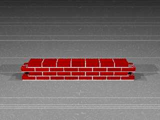

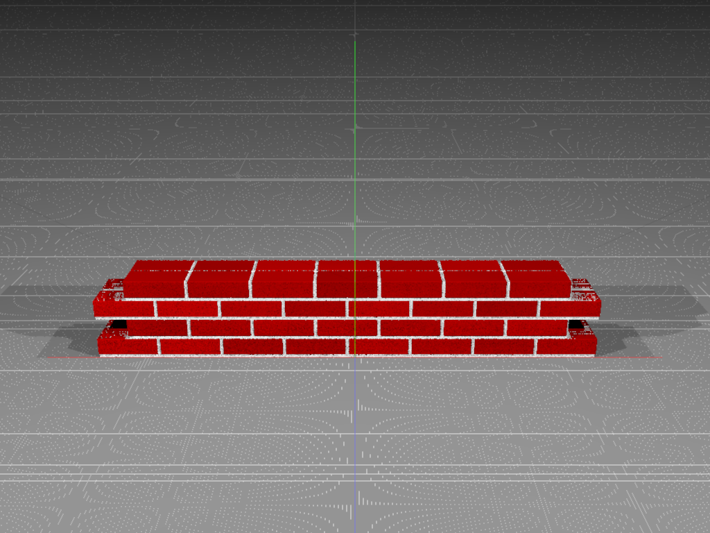

From: Chris R
Date: 3 Jan 2024 13:55:00
Message: <web.6595ac8a992755548a3c0aee5cc1b6e@news.povray.org>
And finally, here is the English bond 3-half-brick wall with mortar.
Note also, the layout system I have defined gives you some nice tools for
setting the texture of the bricks such that individual bricks near each other
can vary, but the texture within a brick stays pretty consistent.
-- Chris R.
Download 'english_bond.png.png' (123 KB)
Preview of image 'english_bond.png.png'

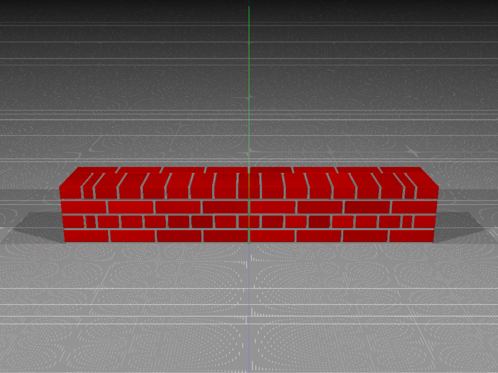

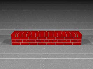

From: Chris R
Date: 4 Jan 2024 10:40:00
Message: <web.6596d14c992755548a3c0aee5cc1b6e@news.povray.org>
> -- Chris R.
Here is a corner with a 2-half-brick English bond wall.  One wall has a white
texture to make clear where the bricks come from in the construction.
-- Chris R.
Download 'english_corner.png.png' (136 KB)
Preview of image 'english_corner.png.png'
