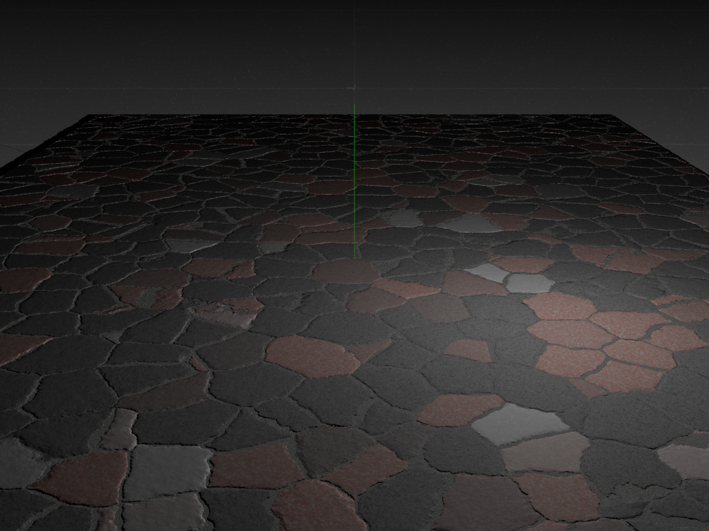

That's brilliant!  I don't know how I missed that in the documentation, (or
maybe I just never understood what it was trying to say).
What controls the pigment value selected for the cell?  Is it just a random
number, or do proximate cells select from the same value range.  I'm finding the
more variation with smaller ranges in my pigment_map, the less "clumpy" the
cells become, but does it follow the normal ramp_wave or is it just a linear
random number?
-- Chris R.

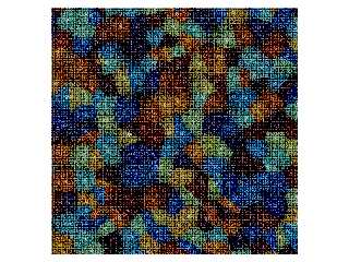

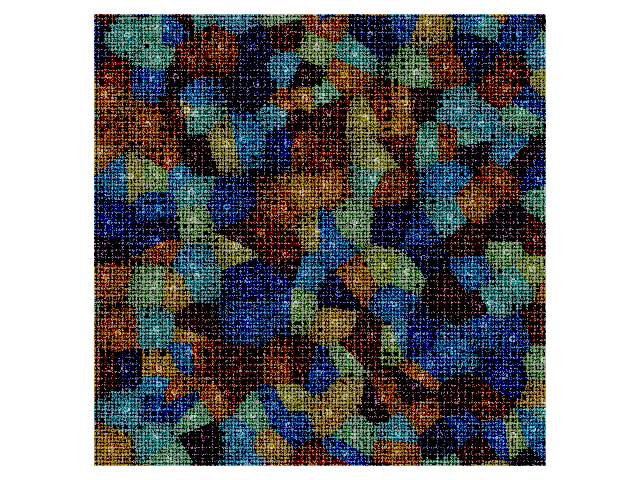

> I've had a lot of success (not 100%) with adapting ShaderToy code to SDL, so
> maybe at some point I can figure out how to make a voronoi pattern in SDL based
> on some of the scripts.
Y'know - like this:
I'm not sure when I make all the squares or spheres fill up everything that it
turns black, with a few colored spots.  My POV-Ray suckage, likely.
But it's proof of concept, so here we go.
Next stage would be to code it using only functions, and then it could be used
as a pigment pattern.
#version 3.8;
global_settings {assumed_gamma 1.0}
#include "colors.inc"
//#include "BezierInclude.inc"
#include "math.inc"
#declare E = 0.0000001;
#declare Camera_Orthographic = true;
#declare Camera_Position = <0.5, 0.5, -100> ;  // front view
#declare Camera_Look_At  = <0.5, 0.5,  0> ;
#declare Fraction = 450;     // functions as a zoom for the orthographic view: 4
zooms in 4x, 8 zooms in 8x, etc.
camera {
 #if (Camera_Orthographic = true)
  orthographic
  right     x*image_width/(Fraction)
  up   y*image_height/(Fraction)
 #else
  right     x*image_width/image_height
  up y
 #end
 location  Camera_Position
 look_at   Camera_Look_At}
sky_sphere {pigment {rgb <1, 1, 1>}}
#declare LS = <0, 0, -20>;
light_source {LS rgb 1}
#declare Line = 0.5/image_width; // line thickness
// DOT product
#declare SFn_vdot = function (ax, ay, az, bx, by, bz) {ax*bx + ay*by + az*bz}
// Length or Norm
#declare SFn_vlength = function (ax, ay, az) {sqrt(ax*ax + ay*ay + az*az)}
#declare Clip = function (_Val, _Min, _Max) {min(_Max, max(_Val, _Min))}
#declare Window = function (_Val, _Eq, _Min, _Max, _E) {select (_Val-_Min, _Val,
select(_Max-_Val, _Val, _Eq))}
#declare LimitReps = function (Element, Period, Min, Max) {Element - Period *
Clip (Element/Period, Min, Max)}
#declare Smoothstep0 = function (_Val, _From, _To) {Clip ((_Val - _From) / (_To
- _From), 0.0, 1.0)}
#declare Smoothstep = function (_Val, _From, _To) {Smoothstep0 (_Val, _From,
_To) * Smoothstep0 (_Val, _From, _To) * (3.0 - 2.0 * Smoothstep0 (_Val, _From,
_To))}
#macro Clamp (N, minVal, maxVal)
 #local Val = min (max (N, minVal), maxVal);
 Val
#end
#macro hash (p)
 // input: 2D vector
 // output: 2D vector
    //p = mod(p, 4.0); // tile
    #local PX = vdot (p, <127.1, 311.7>);
    #local PY = vdot (p, <269.5, 183.3>);
    #local PXr = mod (sin (PX)*18.5453, 1);
    #local PXy = mod (sin (PY)*18.5453, 1);
    <PXr, PXy>
#end
// return distance, and cell id
#macro voronoi (P)
 // input: 2D vector
 #local nx = floor (P.x);
 #local ny = floor (P.y);
 #local n  = <nx, ny>;
 #local fx = mod (P.x, 1);
 #local fy = mod (P.y, 1);
 #local m = <8, 8, 8>;
 #for (j, -1, 1)
  #for (i, -1, 1)
   #local g = <i, j>;
   #local o = hash (n + g);
        // #local r = g - f + o;
   #local rx = g.x - fx + (0.5 + 0.5*sin(clock + 6.2831*o.x));
   #local ry = g.y - fy + (0.5 + 0.5*sin(clock + 6.2831*o.y));
   #local r = <rx, ry>;
   #local d = vdot (r, r);
   #if(d < m.x)
    #local m = <d, o.x, o.y>; // m = vec3 (d, o);
   #end
  #end
 #end
 <sqrt (m.x), m.y + m.z>;
#end
#local M = max(image_width,image_height);
#local D = 1.75;
#macro mainImage (X, Y)
   #local PX = X / M;
   #local PY = Y / M;
   // computer voronoi pattern
   #local C = voronoi ( <(14.0 + 6.0 * sin (0.2*clock)) * PX,  (14.0 + 6.0 * sin
(0.2*clock)) * PY>);
   // colorize
   #local ColorR = 0.5 + 0.5 * cos (C.y*6.2831 + 0);
   #local ColorG = 0.5 + 0.5 * cos (C.y*6.2831 + 1);
   #local ColorB = 0.5 + 0.5 * cos (C.y*6.2831 + 2);
   #local C1 = Clamp (1.0 - 0.4*C.x*C.x, 0.0, 1.0);
   #local ColorR = ColorR * C1;
   #local ColorG = ColorG * C1;
   #local ColorB = ColorB * C1;
   #local C2 = (1.0 - Smoothstep (0.08, 0.09, C.x));
   #local ColorR = ColorR - C2;
   #local ColorG = ColorG - C2;
   #local ColorB = ColorB - C2;
   #local fragColor = <ColorR, ColorG, ColorB>;
   //sphere {<PX, PY>, Line*2 texture {pigment {rgb fragColor} finish {diffuse
1}} }
   //sphere {<PX, PY>, Line*2 pigment {rgb fragColor} }
   box {<PX-Line*D, PY-Line*D, 0>, <PX+Line*D, PY+Line*D, Line> pigment {rgb
fragColor} }
#end
#declare Step = 2;
 #for (Y, 0, image_width, Step)
  #debug concat("Y = ", str(Y, 0, 0), "\n")
  #for (X, 0, image_width, Step)
   mainImage (X, Y)
  #end
 #end
vec2 hash( vec2 p )
    p = vec2(dot(p,vec2(127.1,311.7)),
             dot(p,vec2(269.5,183.3)));
    return fract(sin(p)*18.5453);
vec2 voronoi( in vec2 x )
    vec2 n = floor( x );
    vec2 f = fract( x );
 vec3 m = vec3( 8.0 );
    for( int j=-1; j<=1; j++ )
    for( int i=-1; i<=1; i++ )
        vec2  g = vec2( float(i), float(j) );
        vec2  o = hash( n + g );
      //vec2  r = g - f + o;
     vec2  r = g - f + (0.5+0.5*sin(iTime+6.2831*o));
  float d = dot( r, r );
        if( d<m.x )
            m = vec3( d, o );
    return vec2( sqrt(m.x), m.y+m.z );
void mainImage( out vec4 fragColor, in vec2 fragCoord )
    vec2 p = fragCoord.xy/max(iResolution.x,iResolution.y);
    // computer voronoi patterm
    vec2 c = voronoi( (14.0+6.0*sin(0.2*iTime))*p );
    // colorize
    vec3 col = 0.5 + 0.5*cos( c.y*6.2831 + vec3(0.0,1.0,2.0) );
    col *= clamp(1.0 - 0.4*c.x*c.x,0.0,1.0);
    col -= (1.0-smoothstep( 0.08, 0.09, c.x));
    fragColor = vec4( col, 1.0 );
Download 'new_iq_voronoipattern.png' (416 KB)
Preview of image 'new_iq_voronoipattern.png'

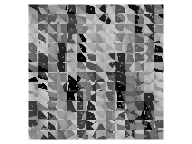

Indeed.   If I knew how this all worked and could code it right.  <eyeroll>
Also, these things are SLOW.
I thought the function version would be faster, but this small render took 23.75
min.
My initial frustration with trying to make one of these things was the nested
loops, but I figured I could "unroll" that and just daisy chain the functions.
Which I did, and it works - sorta.
But it's 102 functions, and for some reason it looks like I got the color code
wrong too.
It also look like there are different methods for generating the Voronoi
pattern, and this one is (obviously) grid based, like POV-Ray's.   I'll have to
try my hand at one with a much more arbitrary data set.

Maybe it would help if I attached the render.   :|
Download 'new_iq_voronoifunction.png' (137 KB)
Preview of image 'new_iq_voronoifunction.png'
