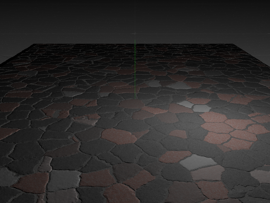

I like to use the crackle pattern for creating stone pavers for floors, rough
stone walls, etc. I use the pattern to outline the stones in an isosurface, and
then apply a texture on it.
This all works well if I want the stones to be of a uniform type, but I haven't
found an effective way to do this when I want some variations in the types of
stones.  I do something similar with brick walls and floors, but since bricks
have a regular shape, I can use warp repeats to ensure that individual bricks
have a consistent texture, but are randomized between bricks.
Has anyone come up with a trick to do something similar with irregular patterns
like crackle?  I usually end up using some sort of random pigment pattern with
the different textures I want to apply, (see the image below), and then
scale/rotate/translate it to match the stones as best I can, but there is always
bleeding between them.
-- Chris R.
Download 'cabin.png' (690 KB)
Preview of image 'cabin.png'

That's brilliant!  I don't know how I missed that in the documentation, (or
maybe I just never understood what it was trying to say).
What controls the pigment value selected for the cell?  Is it just a random
number, or do proximate cells select from the same value range.  I'm finding the
more variation with smaller ranges in my pigment_map, the less "clumpy" the
cells become, but does it follow the normal ramp_wave or is it just a linear
random number?
-- Chris R.

From: Chris R
Subject: Re: Crackle
Date: 14 Nov 2022 11:00:00
Message: <web.637265f9302862a47aaec48e5cc1b6e@news.povray.org>
> > random number?
> From source/core/material/pattern.cpp
> There's a few extra pre-main-pattern sections, and I've always wanted to
> translate the source code algorithm into SDL so that people could vary the field
> of random points, or otherwise modify the pattern to suit their needs.
> The following may also interest you:
http://news.povray.org/povray.binaries.images/thread/%3C5acf08bc%241%40news.povray.org%3E/
Thanks, that's very helpful.  I should probably spend some time looking over the
source code more often.  My C++ is a little rusty from disuse, though.
So, the _map entry based on the node point of the cell, and uses the noise
generator chosen in your global options for the scene.  It doesn't appear there
is a way to separately scale the node points for the call to the noise
generator, so creating more randomness across neighboring cells is a matter of
having fine-grained _maps to choose from.
-- Chris R.

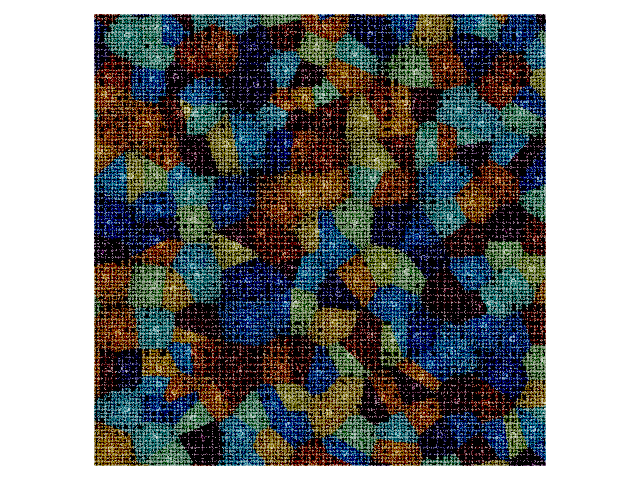

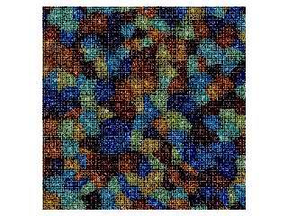

> I've had a lot of success (not 100%) with adapting ShaderToy code to SDL, so
> maybe at some point I can figure out how to make a voronoi pattern in SDL based
> on some of the scripts.
Y'know - like this:
I'm not sure when I make all the squares or spheres fill up everything that it
turns black, with a few colored spots.  My POV-Ray suckage, likely.
But it's proof of concept, so here we go.
Next stage would be to code it using only functions, and then it could be used
as a pigment pattern.

Download 'new_iq_voronoipattern.png' (416 KB)
Preview of image 'new_iq_voronoipattern.png'

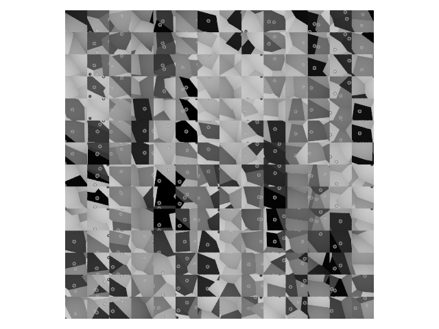

Indeed.   If I knew how this all worked and could code it right.  <eyeroll>
Also, these things are SLOW.
I thought the function version would be faster, but this small render took 23.75
min.
My initial frustration with trying to make one of these things was the nested
loops, but I figured I could "unroll" that and just daisy chain the functions.
Which I did, and it works - sorta.
But it's 102 functions, and for some reason it looks like I got the color code
wrong too.
It also look like there are different methods for generating the Voronoi
pattern, and this one is (obviously) grid based, like POV-Ray's.   I'll have to
try my hand at one with a much more arbitrary data set.
Also: Chris R - are you aware that you can get a Voronoi pattern just using
overlapping cones?  Depending on what you're planning to do with it, that would
be both super easy and FAST.  And from what I understand, it's actually a
legitimate Voronoi result.
https://smathermather.com/2012/01/20/fast-calculation-of-voronoi-polygons-in-povray/
From: Bald Eagle
Date: 15 Nov 2022 14:55:00
Message: <web.6373ed82302862a41f9dae3025979125@news.povray.org>
Maybe it would help if I attached the render.   :|
Download 'new_iq_voronoifunction.png' (137 KB)
Preview of image 'new_iq_voronoifunction.png'

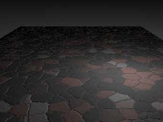

Thanks for the pointers.  I'll check them out.
Most of my work is done with isosurfaces, especially for close-up views of
objects.  I end up coding the basic shape of the object I want as a function and
then apply perturbations using noise generators and pigment patterns to get the
"texture" I want on the surface of the object.  I then apply an SDL texture to
get the color and finish look to the object.
For the tiled floors, and some of my brick wall work, I have to find ways to
make the pigment pattern I use to generate the surface texture to match up with
the pigment pattern I use to generate the colors and finishes.  So, the crackle
pigment pattern works well that way, now that you have shown me how to get a
consistent texture to apply to the cells.  If I need more variability between
cells I'll just have to play with the texture maps and randomize them more.
-- Chris R.
