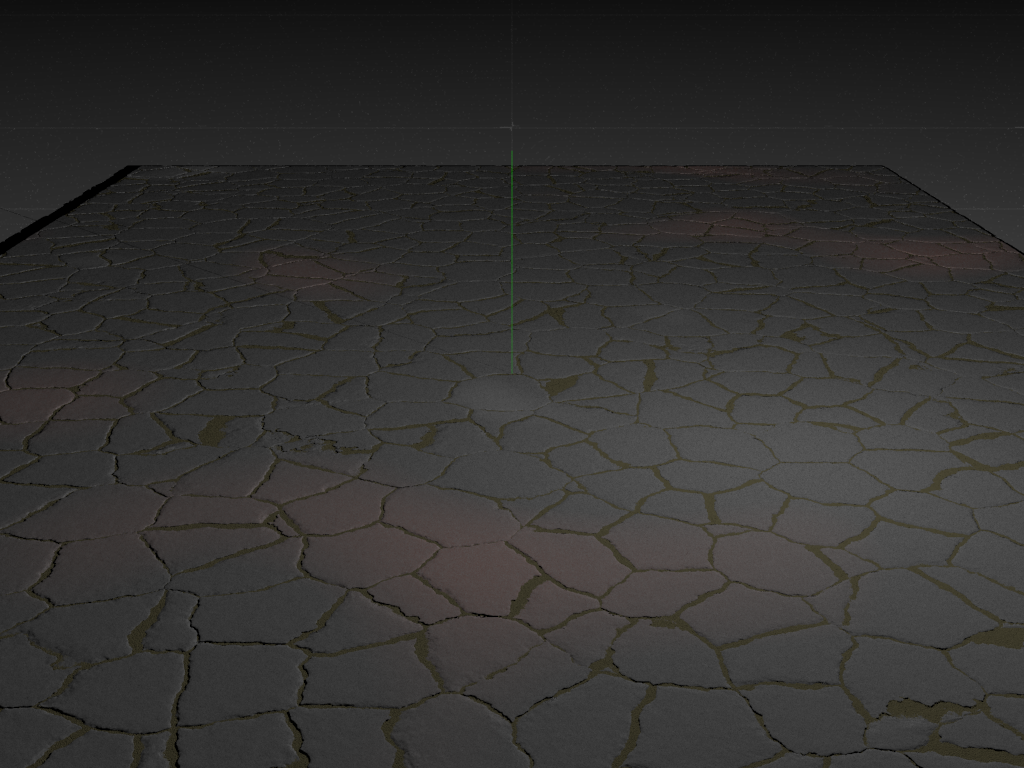

I like to use the crackle pattern for creating stone pavers for floors, rough
stone walls, etc. I use the pattern to outline the stones in an isosurface, and
then apply a texture on it.
This all works well if I want the stones to be of a uniform type, but I haven't
found an effective way to do this when I want some variations in the types of
stones.  I do something similar with brick walls and floors, but since bricks
have a regular shape, I can use warp repeats to ensure that individual bricks
have a consistent texture, but are randomized between bricks.
Has anyone come up with a trick to do something similar with irregular patterns
like crackle?  I usually end up using some sort of random pigment pattern with
the different textures I want to apply, (see the image below), and then
scale/rotate/translate it to match the stones as best I can, but there is always
bleeding between them.
-- Chris R.
Download 'cabin.png' (690 KB)
Preview of image 'cabin.png'

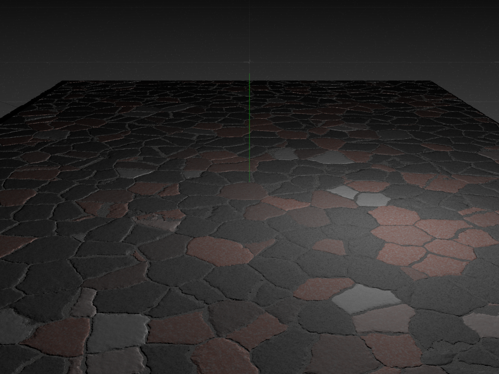

That's brilliant!  I don't know how I missed that in the documentation, (or
maybe I just never understood what it was trying to say).
What controls the pigment value selected for the cell?  Is it just a random
number, or do proximate cells select from the same value range.  I'm finding the
more variation with smaller ranges in my pigment_map, the less "clumpy" the
cells become, but does it follow the normal ramp_wave or is it just a linear
random number?
-- Chris R.
Download 'cabin.png' (730 KB)

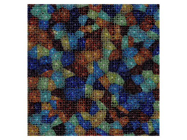

> I've had a lot of success (not 100%) with adapting ShaderToy code to SDL, so
> maybe at some point I can figure out how to make a voronoi pattern in SDL based
> on some of the scripts.
Y'know - like this:
I'm not sure when I make all the squares or spheres fill up everything that it
turns black, with a few colored spots.  My POV-Ray suckage, likely.
But it's proof of concept, so here we go.
Next stage would be to code it using only functions, and then it could be used
as a pigment pattern.
#version 3.8;

#macro mainImage (X, Y)
   #local PX = X / M;
   #local PY = Y / M;
   // computer voronoi pattern
   #local C = voronoi ( <(14.0 + 6.0 * sin (0.2*clock)) * PX,  (14.0 + 6.0 * sin
(0.2*clock)) * PY>);
   // colorize
   #local ColorR = 0.5 + 0.5 * cos (C.y*6.2831 + 0);
   #local ColorG = 0.5 + 0.5 * cos (C.y*6.2831 + 1);
   #local ColorB = 0.5 + 0.5 * cos (C.y*6.2831 + 2);
   #local C1 = Clamp (1.0 - 0.4*C.x*C.x, 0.0, 1.0);
   #local ColorR = ColorR * C1;
   #local ColorG = ColorG * C1;
   #local ColorB = ColorB * C1;
   #local C2 = (1.0 - Smoothstep (0.08, 0.09, C.x));
   #local ColorR = ColorR - C2;
   #local ColorG = ColorG - C2;
   #local ColorB = ColorB - C2;
   #local fragColor = <ColorR, ColorG, ColorB>;
   //sphere {<PX, PY>, Line*2 texture {pigment {rgb fragColor} finish {diffuse
1}} }
   //sphere {<PX, PY>, Line*2 pigment {rgb fragColor} }
   box {<PX-Line*D, PY-Line*D, 0>, <PX+Line*D, PY+Line*D, Line> pigment {rgb
fragColor} }
#end
#declare Step = 2;
 #for (Y, 0, image_width, Step)
  #debug concat("Y = ", str(Y, 0, 0), "\n")
  #for (X, 0, image_width, Step)
   mainImage (X, Y)
  #end
 #end

Download 'new_iq_voronoipattern.png' (416 KB)
Preview of image 'new_iq_voronoipattern.png'

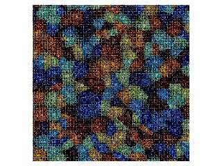

Indeed.   If I knew how this all worked and could code it right.  <eyeroll>
Also, these things are SLOW.
I thought the function version would be faster, but this small render took 23.75
min.
My initial frustration with trying to make one of these things was the nested
loops, but I figured I could "unroll" that and just daisy chain the functions.
Which I did, and it works - sorta.
But it's 102 functions, and for some reason it looks like I got the color code
wrong too.
It also look like there are different methods for generating the Voronoi
pattern, and this one is (obviously) grid based, like POV-Ray's.   I'll have to
try my hand at one with a much more arbitrary data set.

Maybe it would help if I attached the render.   :|
Download 'new_iq_voronoifunction.png' (137 KB)
Preview of image 'new_iq_voronoifunction.png'
