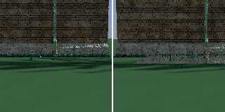

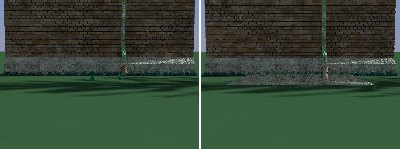

The attached image shows two renderings of the same scene.  The right image is
the same as the left, except that I added a completely transparent box, whose
purpose was to support media with some ground fog:
box {
   -size/2, size/2
   texture { pigment { color rgbt 1 } }
   translate <0, size.y/2, 0>
As you can see, the box shows up as a mirror instead of being transparent.
The scene is fairly complex, but here are a few details that might help point
out to the experts what the problem might be:
1.  The whole scene is inside of a mesh-based sky sphere, but I verified that
the problem shows up even if that is turned off.
2.  I have enabled radiosity, but I verified that the problem shows up without
it as well.
3.  The light source is a sun emulator using a parallel area_light at a far
distance from the scene
I also tried using rgbf 1.0 as the pigment for the box, but I get the same
problem.
Any ideas?  It's driving me crazy
-- Chris R.
Download 'scene-no-media-box.png' (821 KB)
Preview of image 'scene-no-media-box.png'

I took my main scene and eliminated everything but the transparent box, and even
added media to it and everything looked fine.  I added one scene element at a
time back and it was all fine until I added in the drip of water I had modeled
falling from the downspout.  As soon as I added that object back into the scene,
the transparent box with media became a reflective mirror instead!
The drip of water is modeled as a quartic.  It had a material to look like
water, (so transparent, ior 1.33, reflective, etc.).  When I changed the
material to just a simple gray pigment, the media box was no longer visible or
reflective, but the media also disappeared.
I wonder if there is some bug with quartics and textures?
-- Chris R.
> > it as well.
> > problem.
> > -- Chris R.

Thanks, I thought about that too, but I simplified the scene to the point where
there were no more coincident surfaces and it still happened.
-- Chris R.

William F Pokorny <ano### [at] anonymousorg> wrote:
> Unsure...
> What version of POV-Ray is being used?
I am using the latest 3.8 beta.
> Are the shapes involved part of the same union or merge?
My scene, as is my usual practice, is a single union of all of the individual
objects in the scene.
> The only obvious thing I can think of would be if the water material was
> defined by name and happened to have the same name as the one used for
> the media box - and the water material definition was seen last.
The material for the media box was defined inline with the box declaration, so
there could be no name collision.
> If you can get a simpler scene showing the issues I'll add it to my
> collection for debug, though no promises as to when I'd dig. I've been
> busy with other than POV-Ray of late.
I will play around with it and see if I can find something simple and
repeatable.  I had the scene down to just a few elements, but there are a lot of
my own include files involved, so it will take a bit to try and reproduce it.
