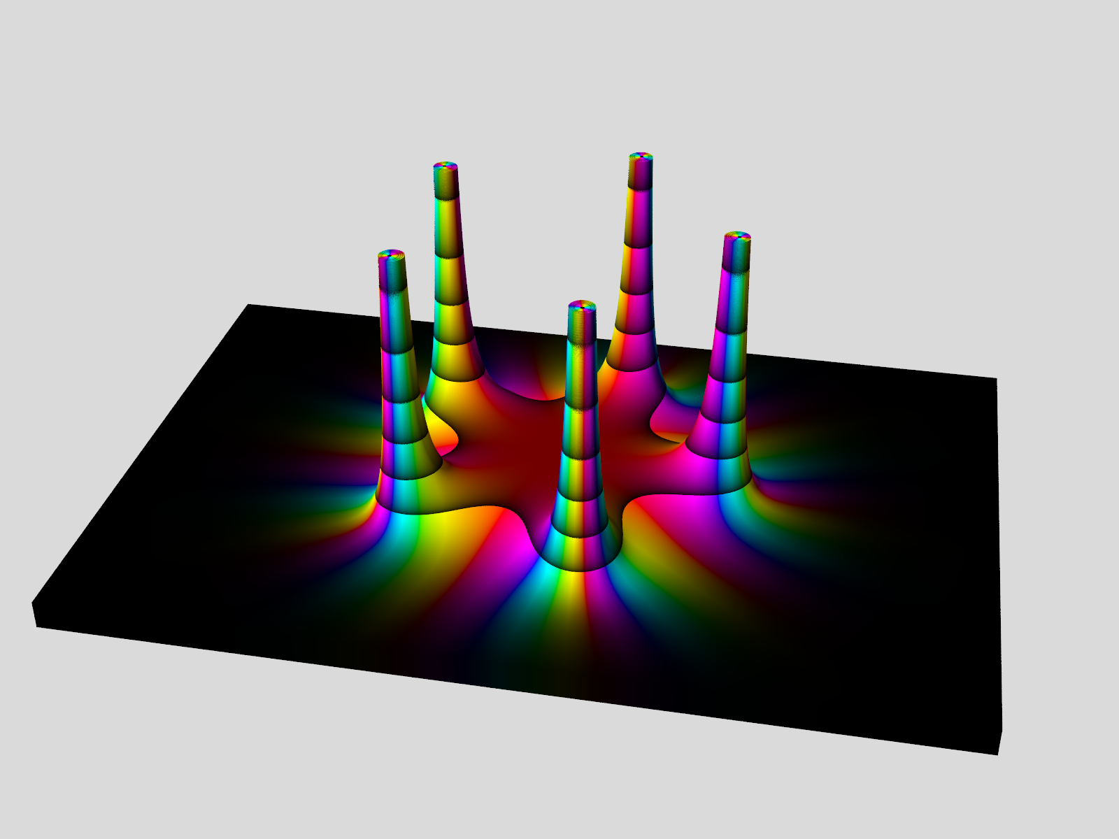

Hi
Since this post:
From: kurtz le pirate
Subject: How to ...
Date: 2021-11-22 11:23:08
http://news.povray.org/povray.general/thread/%3C619bc3ec%241%40news.povray.org%3E/
- I've been working on some some macros that create functions for calculating
with complex numbers.
And yesterday I made some functions that can be used for HSV-coloring of
pigments.
The isosurface in the attached image shows the magnitude (or modulus) of this
function:
  Fn(Z) = 1/(Z^5 - 2)^2
- as the height above a complex plane:. I found that function here:
https://matlabarticlesworld.blogspot.com/2020/01/what-is-coolest-thing-you-can-do-with.html
The colors are chosen so that the hue follows the phase (or argument) of the
function, while the lightness goes from 0.0 to 0.5 in intervals along the height
axis. The saturation is 100% everywhere.
Tor Olav
http://subcube.com
https://github.com/t-o-k
Download 'isosurface from magnitude of complex function.png' (344 KB)
Preview of image 'isosurface from magnitude of complex function.png'

I hope you won't mind that I love it... without understanding it :-)
I don't mind at all =))
Learning the basics of imaginary and complex numbers is not very hard. It's
about learning new ways of adding, subtracting, multiplying, dividing etc. It's
understanding how they can be used and how to interpret the results that can be
challenging.

Very nice.
The "multi-layered" aspect of the result is intriguing me. Does it come from a
property of the function you've choosen, or from the way you choose to visualise
it ?
Pascal

Somehow, this makes me think of black hole gravity wells...
Intriguing!

Do you mean the repeating gradient ?
It comes from the way the «V» of the HSV value is computed, and values
larger than 1 get their integer part zeroed.
Then, it's mapped to a 0..0.5 range.
It could look something like this :
colour_map{
	[0 hsv2rgb(<Hvalue, 1, 0>)]
	[1 hsv2rgb(<Hvalue, 1, 0.5>)]
Those beautiful color gradations remind me of old-style blown-glass/metallic
Christmas tree ornaments; it even appears as if they have blurred reflections.
That's an amazing result. Nice!

This is looking great!  I'm sure there are a lot of other interesting complex
surfaces to be explored.  I'm also wondering how hard it would be to use mod()
to have an infinite array of those "black hole vortices" on a plane - in either
a rectangular or an alternating/hexagonal arrangement...

I mean, looking at the bottom-left corner, or the concentric pattern in the cut
at the top of the singularities, I see it as a superposition of several
surfaces. Also, the shape of the singularities seems to have slight steps, at
the border of what I believe to be each layer. But the more I look at it the
more I feel like I'm just completely confused by the repeating colour pattern
and the shape of the isosurface... which makes this image even more intriguing

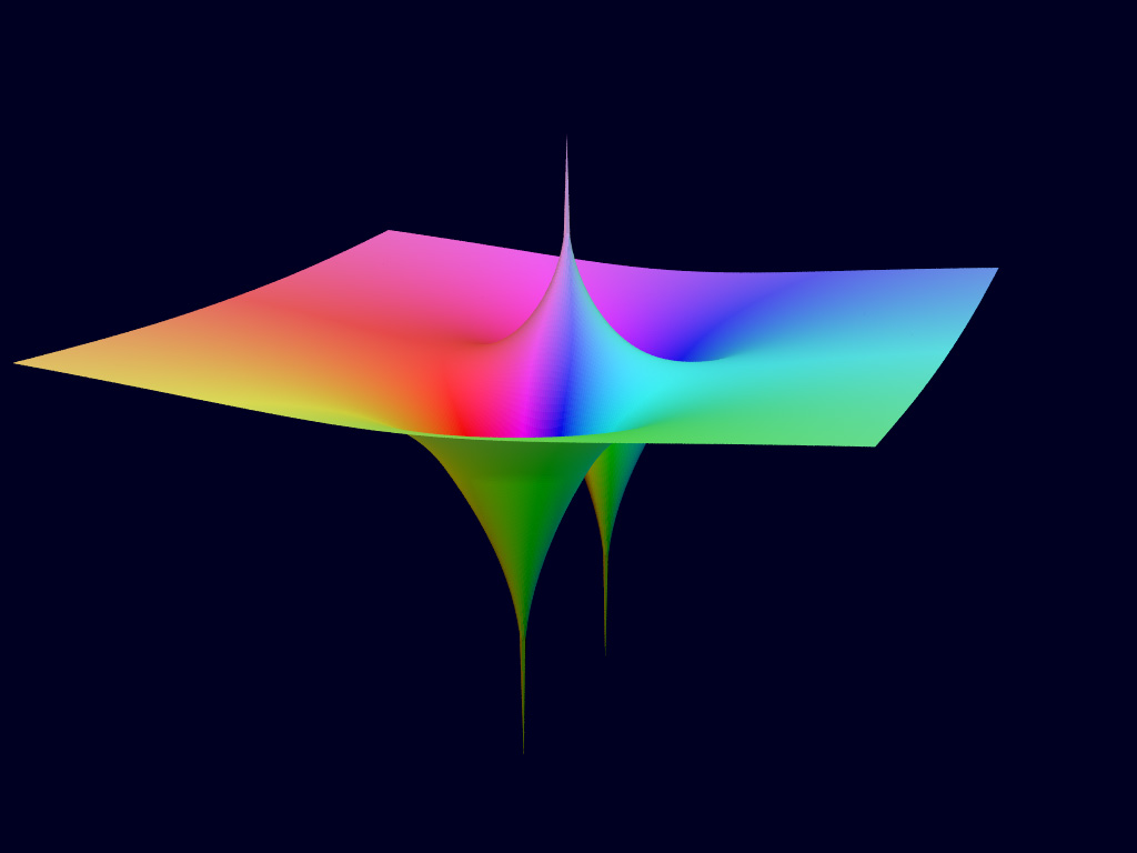

Very good job !
The basic operators on the complexes is much more elaborate than mine. I
use simple macros. This makes the definitions a little more difficult to
work out. For example, for f(z) = z + 1/z, I have to write
complexAdd(cc,complexInverse(cc)).
The really interesting part is the use of isosurfaces. Good job. I just
used colored triangles which give me a {} mesh. The coloring model is
also very clever because the hue and luminosity depend on the value of
the function.
I will see how to add the same coloring scheme as you.
Here, one sample of f(z) = (-z^3 + iz^2 + 1) / (z - 1 + i)^2.
