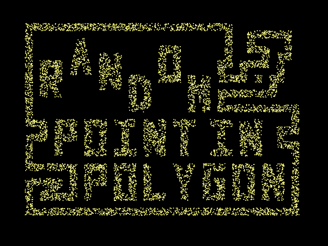

So, somehow I got 3 methods all coded, and hammered out a macro that loops over
all the iterations, and based on the sign of the iteration argument either
returns all the points (pass/fail) or only returns points that pass the inside
test.
But somehow POV-Ray tests the inside of Friedrich Lohmueller's Insert Menu
polygon example ("Lo") just fine, but the
1. crossing number,
2. winding number
http://geomalgorithms.com/a03-_inclusion.html
and
3. What I was able to convert to SDL from POV-Ray 3.7 stable's source code
/source/backend/shape/polygon.cpp
get the part where the bottom of the L doubles back to start the o, and then
goes diagonally up to make the hole in the o reversed.
And my [inept] conversion of the POV-Ray source code performs the worst, mixing
inside/outside results.  :(
Anyway, for now, here's where I'm at, showing the test scene using "-1000" test
points, which shows all the points generated, be they pass or fail, and using
the crossing number as the test method.
my conversion:
 #macro in_polygon (Point, PolygonVertexArray)
  #local number = dimension_size (PolygonVertexArray, 1)-1;
  #local tx = Point.x;
  #local ty = Point.y;
  #local n0 = 0;
  #local n1 = 1;
  #local vtx0 = PolygonVertexArray [n0];
  #local vtx1 = PolygonVertexArray [n1];
  #local first = vtx0;
  #local yflag0 = (vtx0.y >= ty);
  #local inside_flag = false;
  #for (i, 1, number-1)
   #local yflag1 = (vtx1.y >= ty);
   #if (yflag0 != yflag1)
    #local test = ((vtx1.y-ty) * (vtx0.x-vtx1.x) >= (vtx1.x-tx) *
(vtx0.y-vtx1.y));
    #if (test = yflag1)
     #local inside_flag = !inside_flag;
    #end
   #end
   /* Move to the next pair of vertices, retaining info as possible. */
   #if ((i < number-2) & (vtx1.x = first.x) & (vtx1.y = first.y))
    #local n0 = n0+1;
    #local n1 = n1+1;
   #else
    #local vtx0 = vtx1;
    #local n1 = n1+1;
    #local vtx1 = PolygonVertexArray[n1];
    #local yflag0 = yflag1;
   #end
  #end // end for
  inside_flag
 #end
Download 'randomdistributions.png' (36 KB)
Preview of image 'randomdistributions.png'

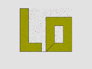

From: Bald Eagle
Subject: Re: in polygon tests
Date: 3 Mar 2021 21:15:00
Message: <web.6040423c5fd06191f9dae300@news.povray.org>
(fixed that error in the outlining of the polygon)
And here's the weird mixed results with the converted POV-Ray method.
Maybe there's a clue in there somewhere.
Download 'randomdistributions.png' (37 KB)
From: Bald Eagle
Date: 3 Mar 2021 21:30:00
Message: <web.6040454b5fd06191f9dae300@news.povray.org>
Which, trying out a guess to account for the lack of programming "tricks" in SDL
vs C++, (I added #local n0 = n0+1; in the second part) fixed the difference, and
now all three methods give me same, but clearly wrong results.
....Or partially right results...  :/
And this is why these things take 100 times longer than they should....

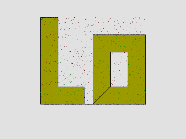

From: Bald Eagle
Date: 4 Mar 2021 14:50:11
Message: <web.604139445fd06191f9dae300@news.povray.org>
Fixed the outlining part of the test macro, and now it's looking pretty nice.

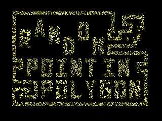

From: Bald Eagle
Date: 5 Mar 2021 15:20:01
Message: <web.604291c85fd06191f9dae300@news.povray.org>
> You should do something about those midges.... ;-)
I took a cue from Robert and set the fireflies loose on them.   :P
Download 'randomdistributions.png' (124 KB)

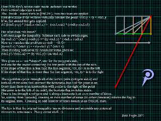

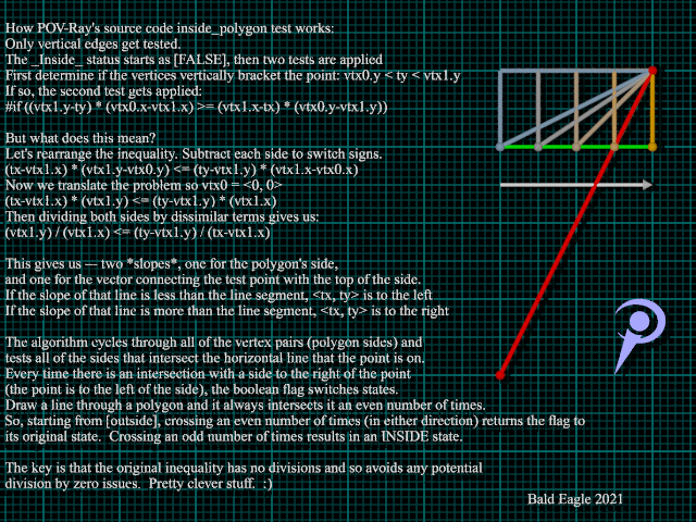

OK, kids.
I wanted to understand how POV-Ray's in_polygon algorithm worked in the source
code.
This took a bit of puzzling over, reading about some similar methods, and
watching a few videos to get a better feel for the geometric implications of the
vector math operations.
This video (at ~34:00) is what put me on the path to seeing what was going on.
https://www.youtube.com/watch?v=vrk2kAuSyLg
I hope I got it right (it seems to be), and that I covered all of the essential
points.
Download 'halfplanemath.png' (288 KB)
Preview of image 'halfplanemath.png'
