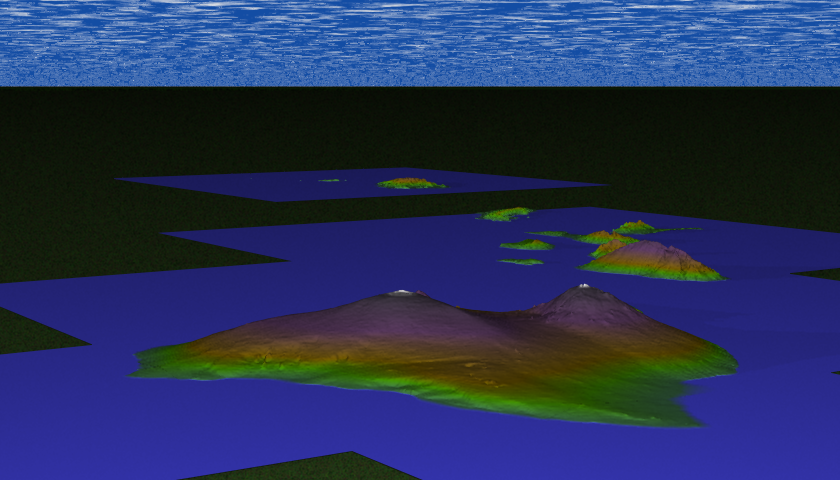

From: Melody
Subject: Kauai
Date: 5 Dec 2019 01:10:01
Message: <web.5de89df1702927829da690110@news.povray.org>
started as Kauai then just did them all.
Spatial res = 3 3 1, not 30,  these are 1x1 degree.
header does not give lon lat coords
and so it had to be formatted from the web page
script needed more vars
case of DEM file Headers have the same name ... DOH!
 %useDEMfilename = 1
  %headformat = 0
  ; 0 old, 1 new
NO rename file made, same-name files for maui
Download 'kauai.png' (423 KB)
Preview of image 'kauai.png'

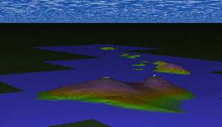

From: Melody
Subject: Re: Kauai
Date: 5 Dec 2019 04:55:00
Message: <web.5de8d3309f12fc349da690110@news.povray.org>
Hawaii parameters 0 0 15 0
Teton parameters  0 0 1 0
even scaled 200
data long shot to being complete
Download 'teton.png' (99 KB)
Preview of image 'teton.png'

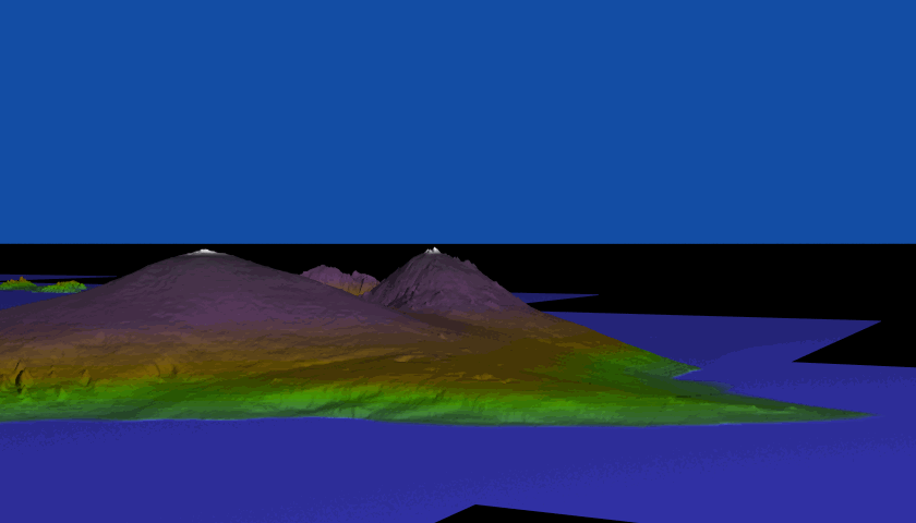

From: Melody
Subject: Re: Kauai
Date: 5 Dec 2019 23:40:00
Message: <web.5de9db199f12fc349da690110@news.povray.org>
sorter failed on longitude
because only 1 of that longitude
now, version 1.8.mrc script. if anyone cares.
I should have waited to post it, but I wont leave a buggy script in the
utilities thread
 where they are supposed to be
yea
Download 'kauai2.png' (421 KB)
Preview of image 'kauai2.png'

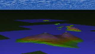

From: Melody
Subject: Re: Kauai
Date: 8 Dec 2019 01:25:01
Message: <web.5dec96a09f12fc349da690110@news.povray.org>
maybe a better texture, because height_field smooth
doesnt seem so smooth
Download 'hawaii2.gif' (2318 KB)
Preview of image 'hawaii2.gif'
From: Bald Eagle
Subject: Re: Kauai
Date: 8 Dec 2019 08:45:00
Message: <web.5decfd769f12fc344eec112d0@news.povray.org>
Believe me, without the smooth, it's a jagged nightmare.
You are really rockin' this digital elevation project - tons of progress and
updates, and I can tell from this animation that there's been a LOT of work
behind the scenes.
Maybe if you touch up the texture(s) and add some normals, then maybe it will
visually smooth things out.   It would also be an amazing feat to be able to get
some maps or satellite photos in register with the 3D landscape - but I've tried
that a little, and it's a registration nightmare.
Again:  Excellent work!   :)
What vertical exaggeration factor did you use?
See you in Khyberspace!
Yadgar

From: Melody
Subject: Re: Kauai
Date: 8 Dec 2019 15:50:03
Message: <web.5ded616e9f12fc349da690110@news.povray.org>
=?UTF-8?Q?J=c3=b6rg_=22Yadgar=22_Bleimann?= <yaz### [at] gmxde> wrote:
> Hi(gh)!
well I used DEMPOVs verticalScale of 15, as it decides the image color range
black green red;, shooting for a mid range.
but that's way too high,
  translate <tx, 0,tz>
  scale < 300, 50, 300 >
just eyeball scale, as I have no idea what it ought to be.
