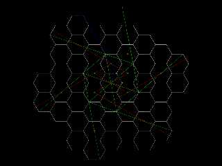

It seems to me that the engine used to throw an error when this happened...
Render attached. The last orange point is out of position. Why this happens at
-60 or 300 degrees and not on the other side, I don't know.
I found a possible workaround, but it's not pretty.
Watch the value of m1:
m1 = 0.500000 / -0.866025 = -0.577350
m2 = 0.327327 / -0.944911 = -0.346410
PC: <1.500000,0.866025,0.000000>
PD: <0.000000,1.732051,0.000000>
PE: <2.000000,1.732051,0.000000>
PF: <-0.500000,2.598076,0.000000>
m1 = -0.500000 / -0.866025 = 0.577350
m2 = -0.654654 / -0.755929 = 0.866025
PC: <0.000000,1.732051,0.000000>
PD: <-1.500000,0.866025,0.000000>
PE: <-0.500000,2.598076,0.000000>
PF: <-2.500000,0.866025,0.000000>
m1 = -1.000000 / -0.000000 = 3900231685776980.500000
m2 = -0.981981 / 0.188982 = -5.196152
PC: <-1.500000,0.866025,0.000000>
PD: <-1.500000,-0.866025,0.000000>
PE: <-2.500000,0.866025,0.000000>
PF: <-2.000000,-1.732051,0.000000>
m1 = -0.500000 / 0.866025 = -0.577350
m2 = -0.327327 / 0.944911 = -0.346410
PC: <-1.500000,-0.866025,0.000000>
PD: <-0.000000,-1.732051,0.000000>
PE: <-2.000000,-1.732051,0.000000>
PF: <0.500000,-2.598076,0.000000>
m1 = 0.500000 / 0.866025 = 0.577350
m2 = 0.654654 / 0.755929 = 0.866025
PC: <-0.000000,-1.732051,0.000000>
PD: <1.500000,-0.866025,0.000000>
PE: <0.500000,-2.598076,0.000000>
PF: <2.500000,-0.866025,0.000000>
m1 = 1.000000 / -0.000000 = -7800463371553961.000000
m2 = 0.981981 / -0.188982 = -5.196152
PC: <1.500000,-0.866025,0.000000>
PD: <1.500000,0.866025,0.000000>
PE: <2.500000,-0.866025,0.000000>
PF: <2.000000,1.732051,0.000000>
A.D.B.

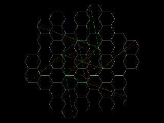

From: Anthony D  Baye
Subject: Re: Divide by negative zero
Date: 26 Oct 2018 00:25:01
Message: <web.5bd296ffa617eb51fd6b6fe10@news.povray.org>
What it should look like.
A.D.B.

"Kenneth" <kdw### [at] gmailcom> wrote:
> clipka <ano### [at] anonymousorg> wrote:
> > Am 26.10.2018 um 05:41 schrieb Anthony D. Baye:
> > > Version 3.8.0-alpha.9606898.unofficial
> > That's on Linux, I presume?
> > POV-Ray does produce a warning if the second operand compares /equal to
> > zero/.
> > [etc]
> For what it's worth, in POV-Ray for Windows v3.7.1 beta 9, I see the same
> results as Anthony's original image-- the misplaced orange dot and the missing
> hexagons at the top.
> The only error messages I get are the expected ones: A missing assumed_gamma,
> and the #version directive not being the first statement in the scene.
> (By adding #version 3.71 , I get the same results, except for a quality
> difference in the renders. But no *new* warning message.)
I've got it working.  There are a couple lines in the IPoint macro that "Fix"
the problem (at least until offsets get really big) by ensuring that the slope
is never undefined.
I'm sure there's a method for finding intersections of two lines that isn't
vulnerable to this problem, but I haven't figured it out yet.
A.D.B.

From: JimT
Date: 30 Oct 2018 05:55:01
Message: <web.5bd82976a617eb51be7517870@news.povray.org>
> Regards,
> A.D.B.
Anthony,
If you use the x(tVal1) = UI1 + Ud*tVal1 , y(tVal2) = VI1 + Vd*tVal2 formulation
for the lines then (x(tVal1)-y(tVal2)).Ud = 0 and
(x(tVal1)-y(tVal2)).Vd = 0 give 2 equations for tVal1 and tVal2. These would
give the nearest points of the pair of lines in 3D or the intersection point of
lines in 2D.
In the following, the only division is by detM, which will only be zero if the
lines are parallel. This will therefore not tread on the +-0 problem POV Ray
seems to have.
Thanks,
JimT
#macro IPoint(UI1, UI2, VI1, VI2)
  #local Ud      = vnormalize(UI2 - UI1);
  #local Vd      = vnormalize(VI2 - VI1);
  #local UddotVd = vdot(Ud,Vd);
  #if(UddotVd    = 1)
    #local rX    = 0;  // Parallel lines so no soln or infinite solns
    #local rY    = 0;
  #else
    #local UV1   = UI1 - VI1;
    #local b1    = vdot(-UV1,Ud);
    #local b2    = vdot( UV1,Vd);
    #local detM  = 1 - UddotVd*UddotVd;
    #local tVal  = (b1 + UddotVd*b2)/detM;
    #local Upt   = UI1 + Ud*tVal;
    #local rX    = Upt.x;
    #local rY    = Upt.y;
  #end
  #local retval  = <rX,rY, 0.0>;
  retval
#end
