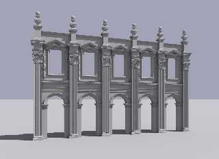

And with light coming from the side... /A
Download 'andreamain_r03_ret.jpg' (493 KB)
Preview of image 'andreamain_r03_ret.jpg'
Subject: Re: Tinkering with textures
Date: 14 Aug 2016 02:47:08
Message: <57b013ec@news.povray.org>
That is pretty good.

This is the building I am after:
https://s-media-cache-ak0.pinimg.com/736x/7f/d0/6c/7fd06c2d2bca8f3dab6e9c8a24c2b072.jpg
https://upload.wikimedia.org/wikipedia/commons/f/fb/MantovaBasilicaSantAndrea_cutnpaste_over_intrusions.jpg
The elevation really shows off the excellent design.
The good part is of course that if there is one thing I can do, it is
modelling architecture. ;)
I might not have time to do all the details exactly right, but I will
be able to do a good model with decent textures. Hoping that you will
give me some much needed advice about textures when we get that far...

The problem with the attached image is not so much about modelling and
design I think, but more about (relative) scale, placement and the light.
The tower is still annoying for example, but if it was a little higher
and further back it could work for the time being.
I will post screenshots as the project progresses. :)
Best wishes, /A

a
detailed pov component. That would be neat if it worked.
The attached image took about 1.5h to create in sketchup and then export to pov,
which is nice, but it cannot "do" any more than just sit there... :p
How much the blocks extrude can be manipulated by scaling, but I really want the
the gap between the blocks as a parameter, it is too hard to choose that in the
beginning and not be able to alter it later.
But I need to put some more thought into design first. For example it might be
necessary to have 2 parameters for level of detail; one for modelling and one
for texture. (Ie you might want to skip the trees when testing, but maybe the
full detail texture needs to be shown, ie with normal etc)
And should the component only pass its parameter on to the sub components?
(It might not be that easy, for at some level, small components should
probably not be drawn at all. Showing also that there should be an LOD = -1
which means do not load or draw at all.)
What is it they say about relations; "Its complicated" ;)
Best wishes, /A
Download 'caprinibtm_suver7_mdl010.jpg' (109 KB)
Preview of image 'caprinibtm_suver7_mdl010.jpg'
