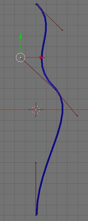

lathe { bezier_spline 8,
    <0,1><0.25,0.75><-0.07594,0.5><0.1875,0.1875>
    <0.1875,0.1875><0.3929,-0.05616><0,-0.5><0,-1>
File '/tmp/Empty.pov' line 17: Parse Error: Incorrect point in lathe.
Fatal error in parser: Cannot parse input.
Render failed
I can't appropriate to control point the negative value...
Why?????
To set the necessary form, I need a negative value!
At the same time the curve doesn't cross null value...
Look attachment:
Download 'lathe.jpg' (27 KB)
Preview of image 'lathe.jpg'

The issue looks to be this code in the parser for the lathe object :
         for (i = 0; i < Object->Number; i++)
                 Parse_Comma();
                 Parse_UV_Vect(Points[i]);
                 if ((i > 0) && (i < Object->Number - 1) &&
(Points[i][X] < 0.0))
                         Error("Incorrect point in lathe.");
which is written in a way which does not allow the bezier control points
to swing to minus x while making some allowance for other curve's
control points.
In other words I think it is testing the control points and not the
fixed end points in each of the bezier curve segments.
Probably simple enough I could attempt a fix... Needs a conditional
based on whether we have bezier curve I think. If someone else is going
after a fix please speak up, otherwise I'll step up and try for one.
Bill P.

I have always wondered what the big deal about negative values was, since once
it gets revolved 180 degrees, it's the positive value.
Can the on-curve points simply be redefined to be positive?
on_curve[n] = abs(original_curve[n]) ?
I could of course, be way off base with this.
The pre-evaluation of the on-curve points for things like Bezier curves would be
an extra subroutine and parser hog, but probably shouldn't be too bad unless
there were a lot of such objects to evaluate.
No,no.
In bezier only 4 control points (P0,P1,P2,P3)
P0,P3 belong a curve, P1 of P2 don't belong a curve.
If P1 = (-2,2), they won't be replaced by a point (2,2).
Other curve will turn out absolutely.
In order that all points of a curve were in positive coordinates, not
necessarily that P1 and P2 also were in positive coordinates.
In the case provided by me the ideal surface of revolution shall turn out.
Restriction from povray is unjustified.

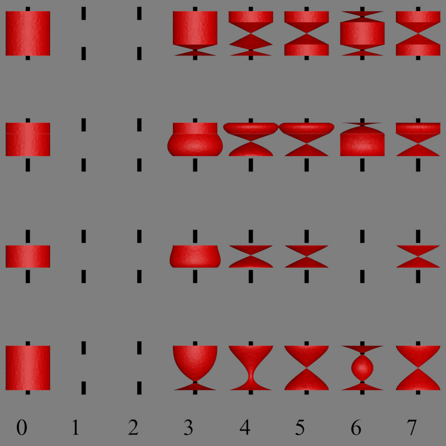

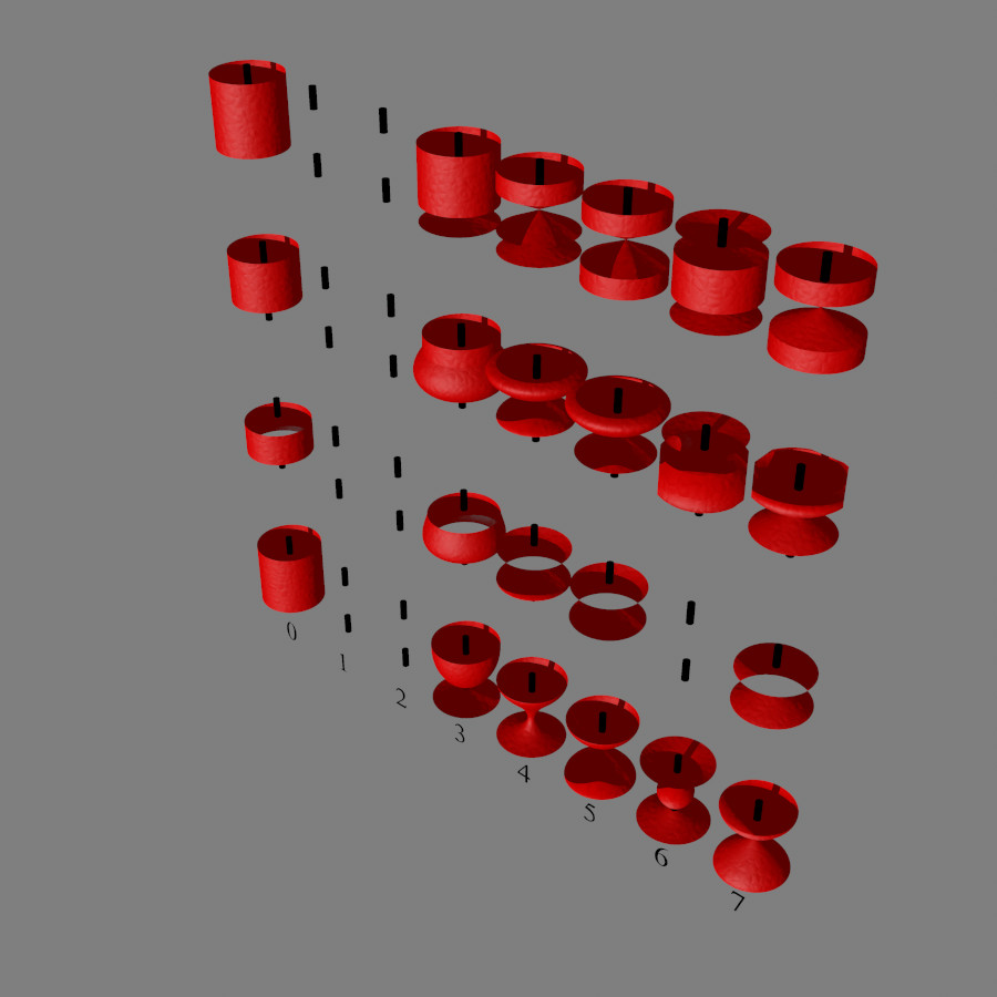

From: William F Pokorny
Subject: Re: Lathe. Bezier_spline. Problem
Date: 2 May 2016 13:47:41
Message: <572792bd@news.povray.org>
On 05/02/2016 11:02 AM, clipka wrote:
> Am 02.05.2016 um 16:37 schrieb William F Pokorny:
>> Rambling I suspect too, both negative control and on curve points will
>> run - though us users might well be confused by any result if really true.
>> If the developers want to allow this, I suppose deleting the current
>> check is the way to go instead.
> How about retaining your work, and simply issuing a warning instead of
> an error? (presuming the downstream code is ok with the values of
> course, otherwise an error is the right thing)
Yes, this looking like it might be an option.
>> In any case for the moment, let me test the cases below with all parser
>> checking off for the different curve types & I will report the results
>> here.
> You're more than welcome.
OK some test results from negative lathe spline values with the current
parse checking off. All splines used have 4 points.
The four rows, top to bottom, are linear, quadratic, cubic and bezier
splines respectively.
The columns 1-7 are:
0 - All X coordinates are positive.
1 - All X coordinates are negative.
2 - All X coordinates are 0.
3 - First point's X coordinate is negative.
4 - Second point's X coordinate is negative.
5 - First and second point's X coordinates negative.
6 - Second and third point's X coordinates negative.
7 - Third and fourth point's X coordinates negative.
I think I covered all the cases somewhat, but if not let me know.
To my eyes we get what one might expect(1) with negative coordinates, so
running with better warnings or no checking at all of the points in the
spline is probably OK.
Bill P.
(1)- except perhaps that quadratic is a bit noisy, but probably it is
not much used.
Download 'orthographic.jpg' (85 KB) Download 'perspective.jpg' (80 KB)
Preview of image 'orthographic.jpg'
Preview of image 'perspective.jpg'
