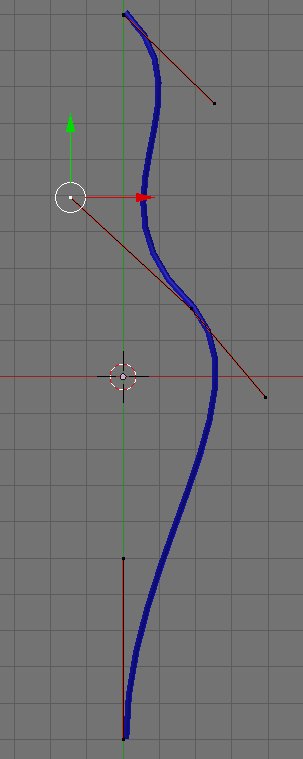

Look attachment:
Download 'lathe.jpg' (27 KB)
Preview of image 'lathe.jpg'

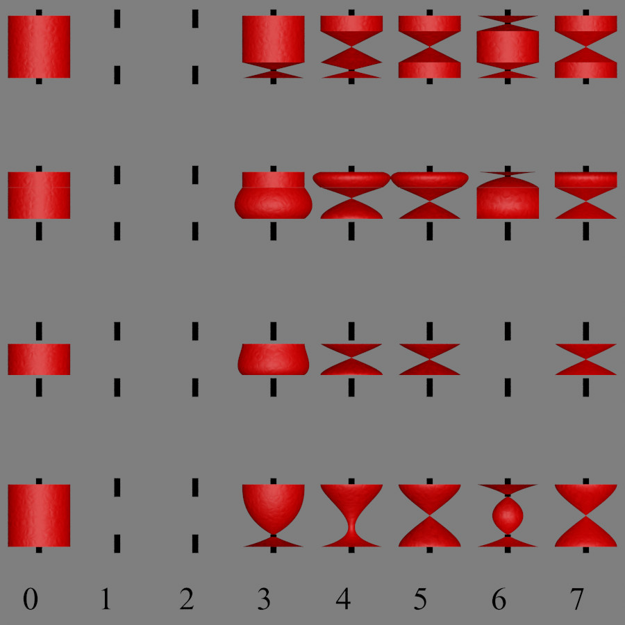

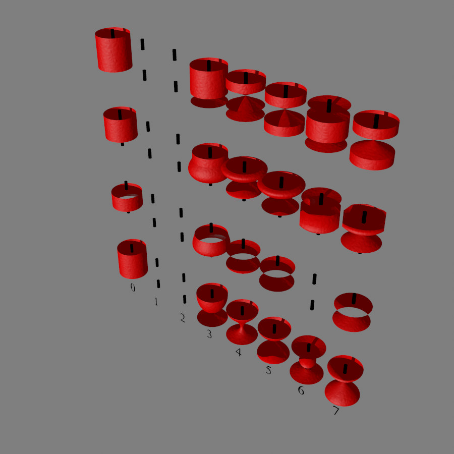

From: William F Pokorny
Subject: Re: Lathe. Bezier_spline. Problem
Date: 2 May 2016 10:37:17
Message: <5727661d$1@news.povray.org>
On 05/02/2016 09:58 AM, clipka wrote:
> Am 02.05.2016 um 14:57 schrieb William F Pokorny:
>> The issue looks to be this code in the parser for the lathe object :
> That is indeed the location in the code that rejects the negative value.
>> Probably simple enough I could attempt a fix... Needs a conditional
>> based on whether we have bezier curve I think. If someone else is going
>> after a fix please speak up, otherwise I'll step up and try for one.
> I would want more to be done than just address the symptoms
Understand. I too recognize more that just the testing of on curve
points for the bezier curve was wrong in what we have today.
Namely it is wrong/incomplete for other curve types too. My initial code
update is this for on curve point test :
                 switch (Object->Spline_Type)
                         case LINEAR_SPLINE :
                                 if (Points[i][X] < 0.0)
                                         Error("Lathe with linear spline
has a point with an x value < 0.0.");
                                 break;
                         case QUADRATIC_SPLINE :
                                 if ((i > 0) && (Points[i][X] < 0.0))
                                         Error("Lathe with quadratic
spline has a point with an x value < 0.0.");
                                 break;
                         case CUBIC_SPLINE :
                                 if ((i > 0) && (i < Object->Number - 1)
                                         Error("Lathe with cubic spline
                                 break;
                         case BEZIER_SPLINE :
                                 if (((i%4 == 0) || (i%4 == 3)) &&
                                         Error("Lathe with Bezier spline
                                 break;
Which seems to be doing the right sort of testing depending on curve
type in forcing on curve points to be >=0 in x.
Thanks for the testing ideas below. Some I'd thought of or believe I've
done in the past, some not.
Rambling I suspect too, both negative control and on curve points will
run - though us users might well be confused by any result if really true.
If the developers want to allow this, I suppose deleting the current
check is the way to go instead.
In any case for the moment, let me test the cases below with all parser
checking off for the different curve types & I will report the results
here.
> (in this
> case a negative control point value being rejected): First thing to be
> done should be some thorough testing...
> - whether the bezier-type lathe can actually deal with negative
> off-curve control points (I expect it can, but that's not necessarily a
> given);
> - whether the bezier-type lathe can live with negative on-curve control
> points (I wouldn't be too surprised if it actually can); and
> - whether any of the other types of lathe can live with negative control
> points (I would expect them to react the same as the bezier type does
> with on-curve points, but that's not a given either).
> Once that's established, the parser code should be adapted accordingly.
> Also, if it turns out that the bezier-type lathe is fine with negative
> off-curve control points but not on-curve control points, some thought
> and possibly effort should be put into the case that some off-curve
> points are so far in the negative regime that the resulting curve gets
> pulled across the axis of revolution.
If we get into this kind of pre-evaluation of the curves, I'll probably
bail. :-)
> That's the reason why I'm not tackling this issue straight away myself.

From: LanuHum
Date: 2 May 2016 13:30:01
Message: <web.57278e889e3d3d247a3e03fe0@news.povray.org>
> Can the on-curve points simply be redefined to be positive?
> on_curve[n] = abs(original_curve[n]) ?
No,no.
In bezier only 4 control points (P0,P1,P2,P3)
P0,P3 belong a curve, P1 of P2 don't belong a curve.
If P1 = (-2,2), they won't be replaced by a point (2,2).
Other curve will turn out absolutely.
In order that all points of a curve were in positive coordinates, not
necessarily that P1 and P2 also were in positive coordinates.
In the case provided by me the ideal surface of revolution shall turn out.
Restriction from povray is unjustified.

OK some test results from negative lathe spline values with the current
parse checking off. All splines used have 4 points.
The four rows, top to bottom, are linear, quadratic, cubic and bezier
splines respectively.
The columns 1-7 are:
0 - All X coordinates are positive.
1 - All X coordinates are negative.
2 - All X coordinates are 0.
3 - First point's X coordinate is negative.
4 - Second point's X coordinate is negative.
5 - First and second point's X coordinates negative.
6 - Second and third point's X coordinates negative.
7 - Third and fourth point's X coordinates negative.
I think I covered all the cases somewhat, but if not let me know.
To my eyes we get what one might expect(1) with negative coordinates, so
running with better warnings or no checking at all of the points in the
spline is probably OK.
Bill P.
(1)- except perhaps that quadratic is a bit noisy, but probably it is
not much used.
Download 'orthographic.jpg' (85 KB) Download 'perspective.jpg' (80 KB)
Preview of image 'orthographic.jpg'
Preview of image 'perspective.jpg'
