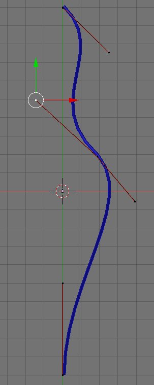

lathe { bezier_spline 8,
    <0,1><0.25,0.75><-0.07594,0.5><0.1875,0.1875>
    <0.1875,0.1875><0.3929,-0.05616><0,-0.5><0,-1>
File '/tmp/Empty.pov' line 17: Parse Error: Incorrect point in lathe.
Fatal error in parser: Cannot parse input.
Render failed
I can't appropriate to control point the negative value...
Why?????
To set the necessary form, I need a negative value!
At the same time the curve doesn't cross null value...
Look attachment:
Download 'lathe.jpg' (27 KB)

The issue looks to be this code in the parser for the lathe object :
         for (i = 0; i < Object->Number; i++)
                 Parse_Comma();
                 Parse_UV_Vect(Points[i]);
                 if ((i > 0) && (i < Object->Number - 1) &&
(Points[i][X] < 0.0))
                         Error("Incorrect point in lathe.");
which is written in a way which does not allow the bezier control points
to swing to minus x while making some allowance for other curve's
control points.
In other words I think it is testing the control points and not the
fixed end points in each of the bezier curve segments.
Probably simple enough I could attempt a fix... Needs a conditional
based on whether we have bezier curve I think. If someone else is going
after a fix please speak up, otherwise I'll step up and try for one.
Bill P.

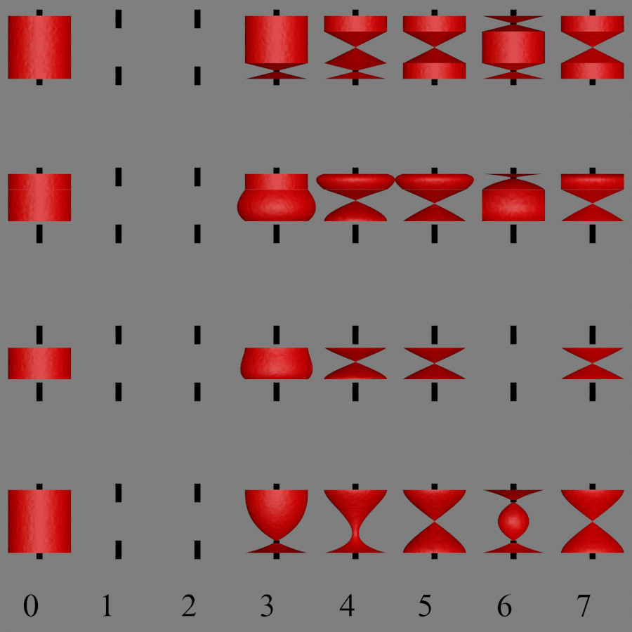

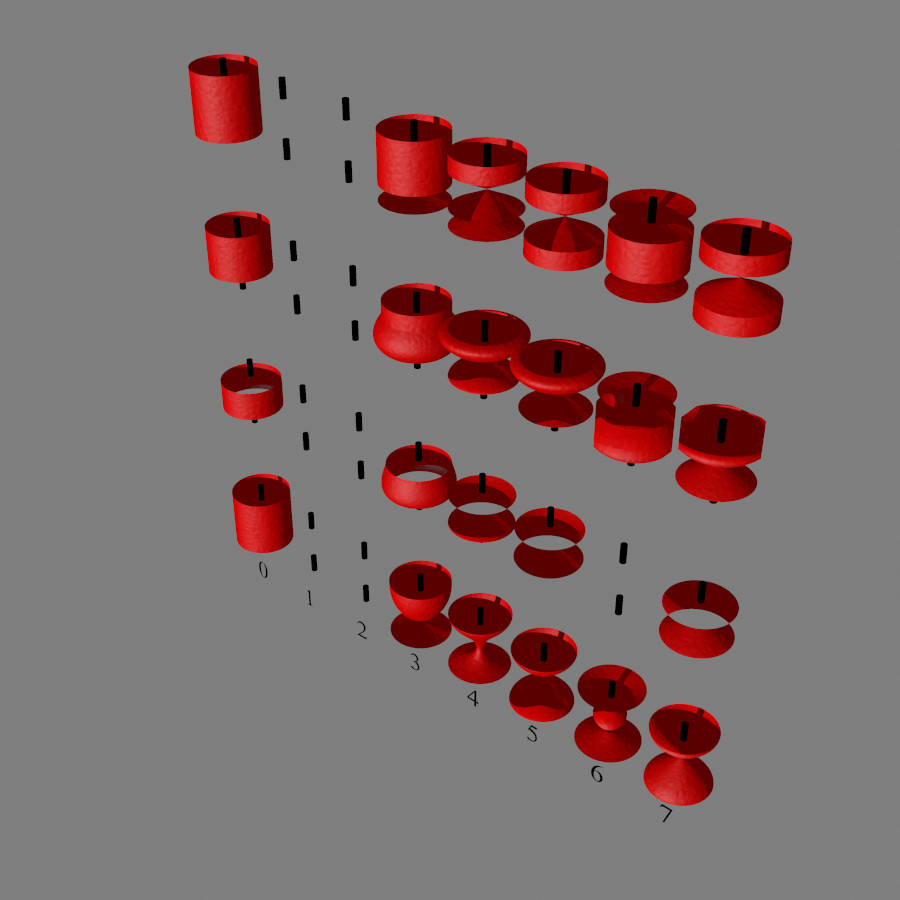

OK some test results from negative lathe spline values with the current
parse checking off. All splines used have 4 points.
The four rows, top to bottom, are linear, quadratic, cubic and bezier
splines respectively.
The columns 1-7 are:
0 - All X coordinates are positive.
1 - All X coordinates are negative.
2 - All X coordinates are 0.
3 - First point's X coordinate is negative.
4 - Second point's X coordinate is negative.
5 - First and second point's X coordinates negative.
6 - Second and third point's X coordinates negative.
7 - Third and fourth point's X coordinates negative.
I think I covered all the cases somewhat, but if not let me know.
To my eyes we get what one might expect(1) with negative coordinates, so
running with better warnings or no checking at all of the points in the
spline is probably OK.
Bill P.
(1)- except perhaps that quadratic is a bit noisy, but probably it is
not much used.
Download 'orthographic.jpg' (85 KB) Download 'perspective.jpg' (80 KB)
Preview of image 'orthographic.jpg'
Preview of image 'perspective.jpg'
