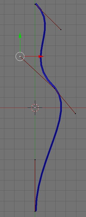

lathe { bezier_spline 8,
    <0,1><0.25,0.75><-0.07594,0.5><0.1875,0.1875>
    <0.1875,0.1875><0.3929,-0.05616><0,-0.5><0,-1>
File '/tmp/Empty.pov' line 17: Parse Error: Incorrect point in lathe.
Fatal error in parser: Cannot parse input.
Render failed
I can't appropriate to control point the negative value...
Why?????
To set the necessary form, I need a negative value!
At the same time the curve doesn't cross null value...
Look attachment:
Download 'lathe.jpg' (27 KB)
Preview of image 'lathe.jpg'

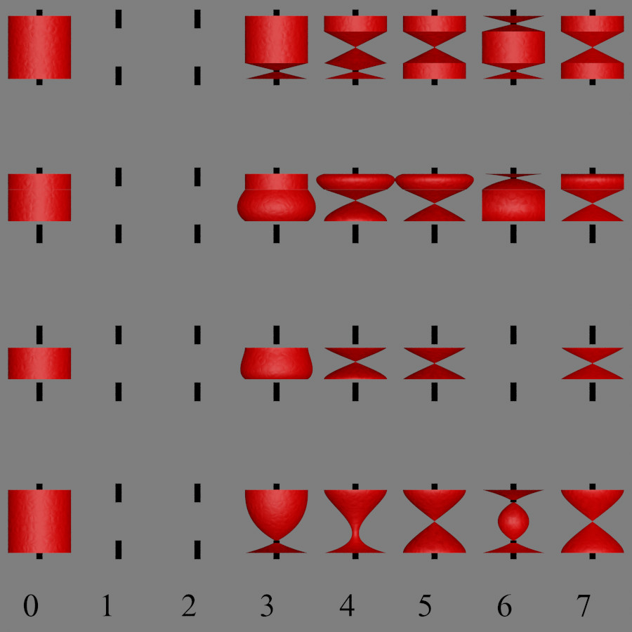

From: LanuHum
Subject: Re: Lathe. Bezier_spline. Problem
Date: 2 May 2016 11:35:00
Message: <web.572772d79e3d3d247a3e03fe0@news.povray.org>
> Am 02.05.2016 um 13:56 schrieb LanuHum:
> > Render failed
> Please do me a favor and file a bug report on
> https://github.com/POV-Ray/povray/issues -- this is probably not the
> right behaviour for Bezier splines, and while I currently don't have the
> time to address this, I don't want it to get lost in time.
I left you a reminder:
From: Bald Eagle
Date: 2 May 2016 12:40:00
Message: <web.572782509e3d3d24b488d9aa0@news.povray.org>
I have always wondered what the big deal about negative values was, since once
it gets revolved 180 degrees, it's the positive value.
Can the on-curve points simply be redefined to be positive?
on_curve[n] = abs(original_curve[n]) ?
I could of course, be way off base with this.
The pre-evaluation of the on-curve points for things like Bezier curves would be
an extra subroutine and parser hog, but probably shouldn't be too bad unless
there were a lot of such objects to evaluate.
From: LanuHum
Date: 2 May 2016 13:30:01
Message: <web.57278e889e3d3d247a3e03fe0@news.povray.org>
No,no.
In bezier only 4 control points (P0,P1,P2,P3)

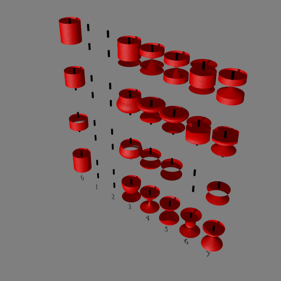

OK some test results from negative lathe spline values with the current
parse checking off. All splines used have 4 points.
The four rows, top to bottom, are linear, quadratic, cubic and bezier
splines respectively.
The columns 1-7 are:
0 - All X coordinates are positive.
1 - All X coordinates are negative.
2 - All X coordinates are 0.
3 - First point's X coordinate is negative.
4 - Second point's X coordinate is negative.
5 - First and second point's X coordinates negative.
6 - Second and third point's X coordinates negative.
7 - Third and fourth point's X coordinates negative.
I think I covered all the cases somewhat, but if not let me know.
To my eyes we get what one might expect(1) with negative coordinates, so
running with better warnings or no checking at all of the points in the
spline is probably OK.
Bill P.
(1)- except perhaps that quadratic is a bit noisy, but probably it is
not much used.
Download 'orthographic.jpg' (85 KB) Download 'perspective.jpg' (80 KB)
Preview of image 'orthographic.jpg'
Preview of image 'perspective.jpg'
