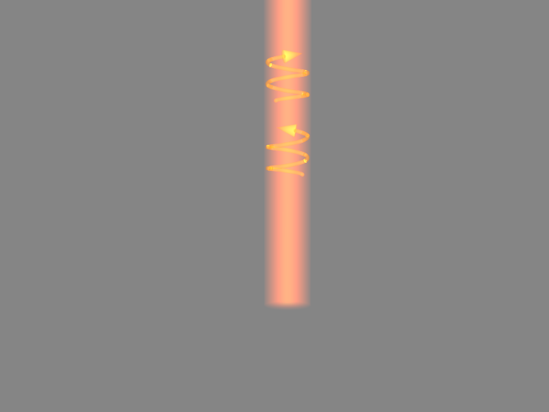

The file umbach-spline_question-3.7.png is my result from the 3.7
render.  Does it show the problem you have?
I was unable to get rid of the artifacts.  My best suggestion is to
download the SphereSweep module from the Object Collection, put the line
#include "spheresweep.inc" near the top of your scene file, and delete
the sphere_sweep object in your code, replacing it with:
         #local Radii = array [2] { 0.05, r }
         #local CtrlPts = array [points]
         #local CtrlPts[0] = <0,0,0>;
         #for (pt, 1, points - 1)
           #local CtrlPts[pt] =
             <R*cos(pt*P+ph+ph_tot_), pt*L, R*cos(pt*P+ph_tot_)>;
         #end
         SphereSweep_Approx (SSWP_CUBIC_SPLINE, CtrlPts, Radii, 5, 0)
You will get a warning about the spline feature.  Ignore it.
The SphereSweep module can be downloaded at:
http://lib.povray.org/searchcollection/index2.php?objectName=SphereSweep&contributorTag=Cousin%20Ricky
My result is the file umbach-spline_question-sswp.png.  Because you are
using 3.7, I felt free to use a #for instead of a #while.  There are
bright areas where the coils are normal to the camera, but this is due
to the longer trace path through the emitting media, rather than a bug
of any sort.
I also replaced the union in macro emission_3 with a merge, to eliminate
the dark spot where the cone joins the coil.  Although the POV-Ray
documentation doesn't recommend merge with sphere_sweep objects, it does
not appear to cause any problems in this case.
