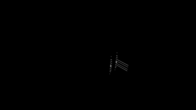

The antennas on the right side should be identical to the antennas at the left
side, but they aren't. Unless I miss to discover since several hours an error on
my side, I think, I have discovered a serious programming fault in the new
POV-Ray 3.7.
Please test my scene source code and give me a feedback. Thanks.

#macro HullCommandFrontCutout(MyAmount,MySize,MyWidth,MyBegin,MyTexture)
union
 #declare MyY=seed(1);
 #declare MyZ=seed(2);
 #declare MyHeight=seed(3);
 #declare MyCount=1;
 #while (MyCount<=MyAmount)
  #declare MyBoxY=rand(MyY);
  #declare MyBoxZ=rand(MyZ);
  #declare MyBoxHeight=rand(MyHeight);
  box
   < -MyWidth, (-MySize*MyBoxY), -1000.0 > < MyWidth, (MySize*MyBoxY),
((-MyBegin)-(50.0*MyBoxZ)) >
   translate < 0.0, -(400.0*MyBoxHeight), 0.0 >
  box
   translate < 0.0, (400.0*MyBoxHeight), 0.0 >
  #declare MyCount=MyCount+1;
 #end
 texture { MyTexture }
#end
difference
 union
  box { < -62.5, -200.0, -325.0 > < -61.0, 200.0, -300.0 > }
  box { <  61.0, -200.0, -500.0 > <  62.5, 200.0, -300.0 > }
 HullCommandFrontCutout(125,10.0,150.0,275.0,TextureHullSide)
 texture { TextureHullSide }
Download 'sl - seneca ii.png' (6 KB)

The fault is all yours.
Replace:
by:
     box { < -62.5, -200.0, -500.0 > < -61.0, 200.0, -300.0 > }
in your difference block and all is symmetrical.
