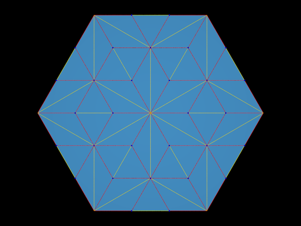

I was going to wait to debut this until I'd gotten the finished product done,
but I could use a second (or third/fourth/etc..) set of eyes on the problem.
The problem is an aperiodic tiling with sixfold symmetry, and it almost works,
but suddenly fails at anything more than 3 levels deep.
the following snippet is from geometry.pov, and I believe this is where the
problem is:
        push(array[3] { t1[1] + baseVec*baseLen/3, t1[0], t1[1] })
        push(array[3] { t1[0],
                        t1[2] - baseVec*baseLen/3 })
        push(array[3] { t1[1] + baseVec*2*baseLen/3, t1[0], t1[2] })
if I comment out the second push operation, the ugliness goes away, but no more
equilateral triangles are introduced and the pattern has large (if interesting)
gaps in it.
I would appreciate it if anyone could help me with this.
sorry about the messy code.  The image shows the pattern at 3 levels deep.
A.D.B.

From: Bald Eagle
Subject: Re: A puzzling problem
Date: 7 Nov 2014 10:25:00
Message: <web.545ce417eb43a3ad5e7df57c0@news.povray.org>
> problem is:
What's a push operation? - I didn't see anything under arrays in the docs, and a
quick search in the help index didn't pull anything up.
All I can say is, that from my ignorant standpoint, I'd start with "Which one of
these 3 things doesn't look like the other 2".  The second push is the only one
with TWO mathematical operations.
I'd start by messing with that and passing values to a debug stream.
From: Anthony D  Baye
Date: 8 Nov 2014 02:00:10
Message: <web.545dbe90eb43a3ad1538d4890@news.povray.org>

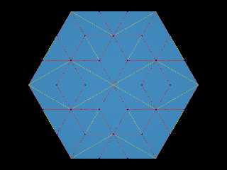

Turns out that the problem was in my centroid calculation...
A.D.B.
