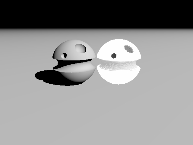

I tried a very crude implementation of my crevice grime idea (p.g) to see how it
would work in general.  The object on the left is my base object.  On the right
is my crevice results.
For this I am basically tracing a regular set of points around my object.  I
then use tha point and normal found to run a series of traces at some angle from
the normal rotated around the normal (in this case I am using 32 traces at 75
degrees).  I then check for intersection and distance to intersection for all
traces and then place a sphere on the surface at that location that is coloured
based on the average distance to intersections.
Very crude, but it appears to work somewhat, other than I would have liked to
colour my object directly rather than the little spheres.  I am also using a
regular spherical array of traces from the center of the base object.
Perhaps one day I will get into the internal code and see if it's possible to
code internally.
-tgq

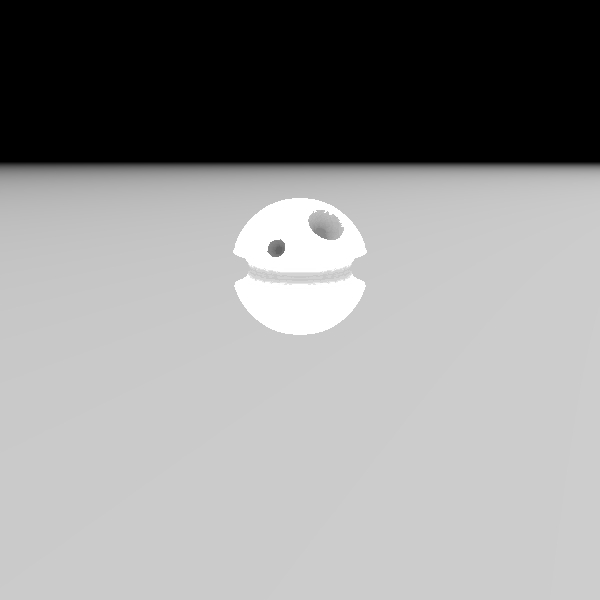

I have done some adjustments to my testing.  I reverted to using a
pseudo-raytrace method for sampling: a square grid of traces from the camera to
the object.  This gives much more effective coverage and ignores unseen surfaces
(not good for reflections yet).
I also tried out the harmonic mean approach to the colouring,as per clipka's
suggestion, and it looks ok at present.  The only problem I foresee with it is
that it is not bounded by 1, however this may work out favourably by truncating
at 1, which would mean any value above 1 has zero effect.
This run uses a normal offset of 60deg, with 32 rotated samples.  It coulred by
a direct harmonic mean of standardized distances (distances are standardized by
len/D where D=40, note the main sphere is 80 diameter).
I may still look at alternate distance weighting options such as inverse power
(1/2^x)
-tgq

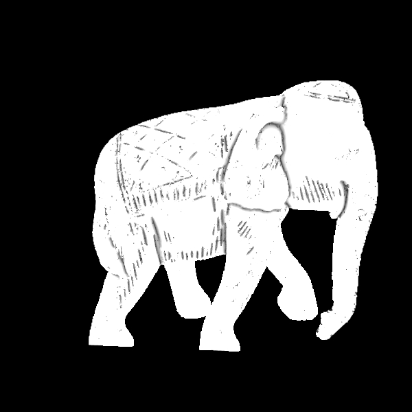

Message: <web.4d7e38be50dd01dd81c811d20@news.povray.org>
Had a bit of an error in how I was handling my harmonic mean function that I
fixed.
Here is a run on a real mesh, and it looks like there may some potential.
For scale, the elephant mesh is approximately 240x220x110.  I have run a 500x500
sampling grid over a ~350x350 square.  Note:I am using a square that uses the
diagonal corner length of the mesh bounding box, so it tends to end up larger
than it needs to be, but this just easily ensures that I am sampling the whole
object without having to sample the whole image/scene.
The other settings I used were:
normal angle = 75deg;
normal samples = 24;
standardized depth for harmonic mean = 10
-tgq
Download 'trace2.jpg' (77 KB)
Preview of image 'trace2.jpg'

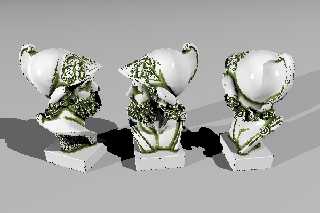

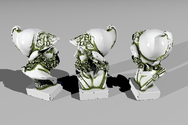

Another test on a more complex mesh object.  Here I have run 3 different
instances. Note each one has to be run separately and translated/rotated before
running the algorithm, otherwise the untraced areas would be visible.
Here the general object size is 200units high.  Crevice checking is done for a
control depth of 15units, normal angle of 75deg, 16 traces per point.
I also changed the object I am using to show my crevice solouring, I am now
using mesh 'pixels' that extend back into the camera point (mesh because they
are a 4-sided pyramid of sorts), but intersected with the base object.  This way
I get a sharp transition from each pixel, with no overlap.  One downfall of this
is that I have to texture my base object after using it in the grime (or use an
untextured instance) as the intersection CSG operation causes my grime pixel to
adopt the base object texture otherwise.
The grime is a little pixelated here, because my general pixel size is ~2x that
for the image resolution.
-tgq
> -tgq
