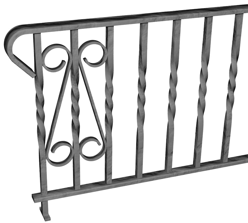

A hand rail that will end in the background of a scene with stone work and the
front of a building.
The isosurface gives a smooth transistion from straight/twist/straight.
Also includes some CSG and a surface normal.

Comments welcome:
Stephen S
Good work, glad you figured it out.
I think the surface normals should probably be scaled down for the kind of
finish I would expect for this object.  (probably ~2-4X)
How is the render time for the isosurface?  For this kind of object, a
procedural mesh may be ideal, but requires a headache's worth of math and logic
coding :)
tgq
