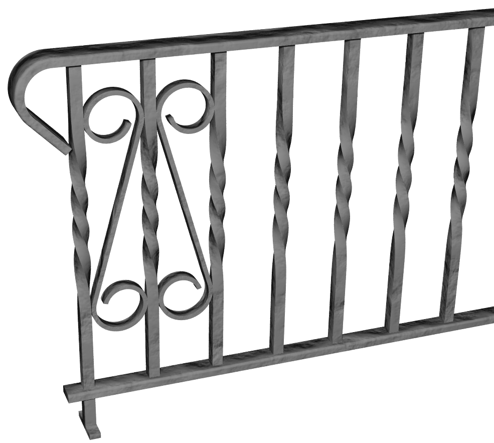

A hand rail that will end in the background of a scene with stone work and the
front of a building.
The isosurface gives a smooth transistion from straight/twist/straight.
Also includes some CSG and a surface normal.

Comments welcome:
Stephen S

From: Trevor G Quayle
Subject: Re: Hand rail, smooth isosurface twist
Date: 8 Feb 2011 01:20:04
Message: <web.4d50dfa4830bd89ab05ef170@news.povray.org>
Good work, glad you figured it out.
I think the surface normals should probably be scaled down for the kind of
finish I would expect for this object.  (probably ~2-4X)
How is the render time for the isosurface?  For this kind of object, a
procedural mesh may be ideal, but requires a headache's worth of math and logic
coding :)
