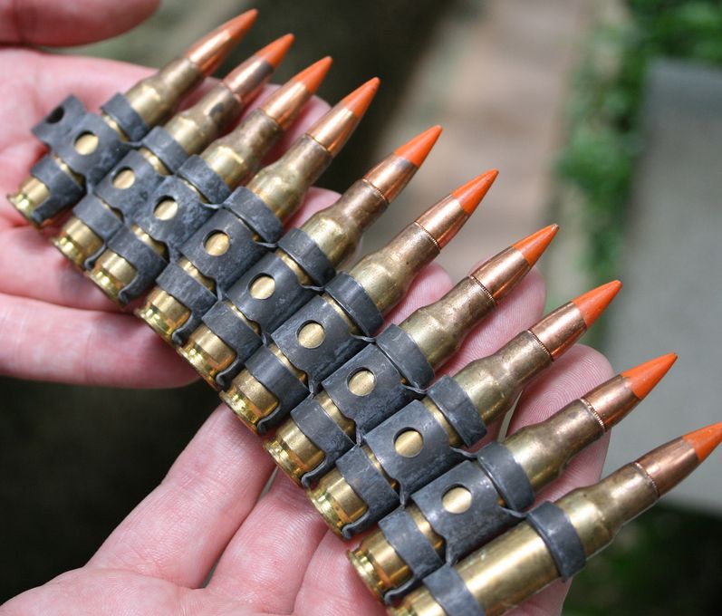

Hello,
Somehow I was able to find a way to fit some bullets into the scene I've been
working on. What luck! They'll need to be linked together since they're machine
gun bullets. This photo shows the type of link I copied. I think I can only
attach one picture per posting so I'll have to attach the rendered images as
replies.
I hope nobody minds multiple pictures...
Dave Blandston
Download 'm13_1.jpg' (82 KB)
Preview of image 'm13_1.jpg'
