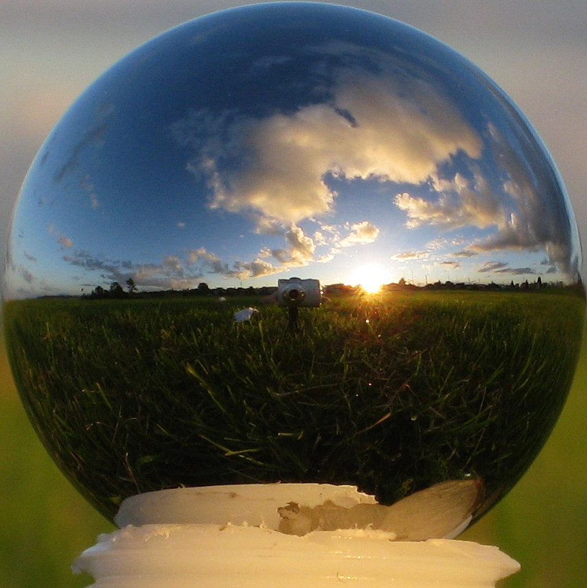

I've been trying to make some HDR light probes over the last few weeks. It's
tricky. :) The "stainless steel" balls I got from a garden centre were not up
to scratch... much deformation was apparent on the surfaces. They weren't even
stainless steel - plastic with a chrome coating probably, and even the
strongest permanent magnet I could lay hands on failed to grip the surface more
than fractionally.
So, I purchased a 60mm ball bearing from ebay instead, and this seems to work
very well. It has some slight scuff-marks which I can no doubt polish out in
time, but otherwise gives very sharp reflections.
My camera seems adequate to the task, although it would have been very difficult
without the CHDK upgrade to the Canon firmware (thanks to tgq for the link). I
have two tripods, which I have 'calibrated' for HDR-gathering (even drawing a
line round the neck of the larger one to mark the elevation!), and a great
little plastic tub-thingy which sits on the larger tripod and supports the ball
nicely.
However, I am having a few problems, particularly with image alignment. I'm
using HDRShop for the whole process, following the tutorial here:
http://gl.ict.usc.edu/HDRShop/tutorial/tutorial5.html
It works a treat, but often I find that the rotated image doesn't quite match
the other image after unwrapping. The points I select in the editor match
perfectly, naturally, but the images seem to diverge near the edges. I'm not
entirely sure why this is happening, but making sure the ball is centred in the
frame when taking the pictures seems to help considerably. Can any resident
HDR-makers shed any light on this?

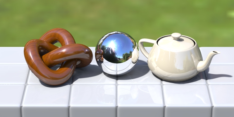

In any case, here's my test scene so far, using the probe I made at the weekend.
I don't have a light-dome setup so I've cheated a little by using a single
light-source to account for the sun.

Your ball bearing is about 2.3 times bigger than mine, so it should be able to
give much better images. How much did you pay for it? I'm don't know where to
look for bigger ball bearings where I live...
My one inch ball bearing occupies about 850 pixels square with my 8 megapixel
camera (Canon IXUS 860). You should be getting 2000 square pixels or so?
Make sure you take the photo at maximum zoom to reduce the distortion of the
ball - this will help in stitching the two images together.
From what I can tell, the combination of magnification and bright light sources
(the sun or point-like interior lights) brings out even the smallest
imperfections in the polishing. I got my ball chrome plated, and that made a
huge difference. Almost no flare from the sun from the ball bearing surface
(but still a little from the cheaper lens on the point and shoot camera).
One last point - my ball bearings (I got three) started rusting after a couple
of months of use. I'm not sure exactly what your one is made of, but don't
touch it with your fingers, and clean it with a lint free cloth whenever you
use it or store it. I'm hoping the chrome plating on my third one will mean it
will now never rust...
> nicely.
CHDK is an absolute marvel :-) I used the custom grid function to draw a circle
and crosshairs that precisely matches the position of the ball on screen to aid
in getting it at exactly the right distance. I also used the "override focus"
setting to force the camera to focus on the minimum distance at maximum zoom.
Getting the ball in perfect focus had been a real problem up until that.
I use HDR shop to convert the images from spherical mirror projection (i.e. the
HDR photograph) into Latitude/Longitude format, then do the stitching in
Photoshop. I think there is an HDR version of GIMP - Cinepaint? Everything is
much simpler to do in square lat/long format, and POV can use the resulting
images just fine.
Having the two images taken at max zoom will help, as will making sure that they
are taken from exactly the same elevation and that the camera is absolutely
level. I find I have to do a little stretching and fudging in Photoshop even
when I'm really careful about that stuff - it's just a case of minimising the
work required.
Looks pretty great already - I'm really jealous of the extra resolution you are
able to get!
I paid GBP17 + postage, about GBP21 in total. It was from a uk seller, which
helped (cos that's where I am!). The guy was also selling balls up to 100mm,
but those were 45 quid (not counting postage!).
That's about right, my camera's 7.2Mp and I can juuuust get it focused at full
zoom from about half a meter away, although I can't get it to focus full-frame.
I'm getting 1700 pixels square after cropping. Perhaps I'll try the focus
override - forgot about that.
> huge difference.
Yup, I'm seeing quite a bit of flare from the scuffs on mine - you can see it in
the attached image!
> use it or store it.
I think it's stainless steel, so I shouldn't have any problems. I've never had
stainless steel rust before except through wet contact over months. Where on
earth can I get it chrome-plated, and how much would that cost?! :)
Aye, I mean to use the grid eventually too. I have a 'manual' focus on my
Powershot, but it's a bit primitive. The override should help!
> images just fine.
Actually the blending is very straightforward in HDRShop, I can knock up a mask
in the GIMP in about 5 minutes. I don't have Photoshop, so I am limited in my
retouching facilities. I should see if Cinepaint works under wine...
> level.
I have been, but I get the impression that elevation is not a problem when I'm
using HDRShop's 3D rotation during unwrapping. Keeping a constant distance
would seem to be vital, however - I'd guess the difference in perspective will
affect the squashed reflections at the edges quite strongly.
> able to get!
Thanks, I'll put up a page of probes somewhere when I've got a few more!

What exact difficulties are you having?
Try to follow the tutorial exactly.  The point matching and masking are the
trickiest parts to master I find.

One of my shots - to give you an idea of the source material I'm getting with a
1 inch ball.
Cheers,
Edouard.
Download 'img_8257.jpg' (252 KB)
Preview of image 'img_8257.jpg'
> 1 inch ball.
That's great - much clearer than I've managed so far even with my bigger ball. I
really need to polish it and investigate that focus override... :)
