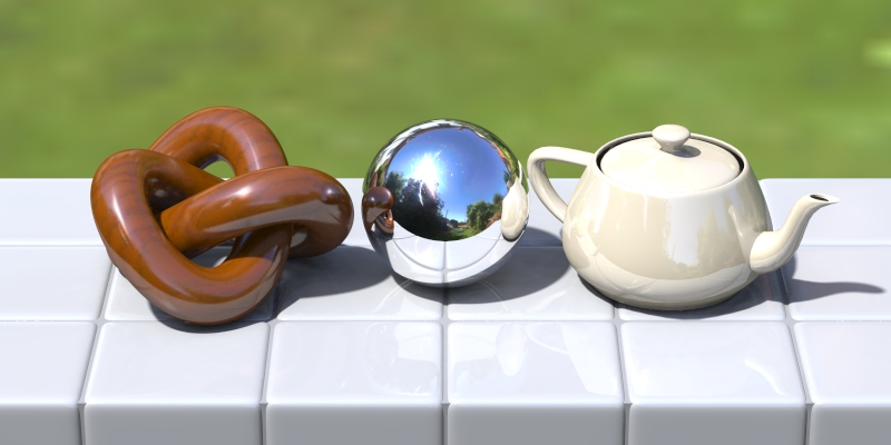

In any case, here's my test scene so far, using the probe I made at the weekend.
I don't have a light-dome setup so I've cheated a little by using a single
light-source to account for the sun.
Bill
Download 'hdr_tester.jpg' (111 KB)
Preview of image 'hdr_tester.jpg'
Looks pretty great already - I'm really jealous of the extra resolution you are
able to get!
> able to get!
Thanks, I'll put up a page of probes somewhere when I've got a few more!

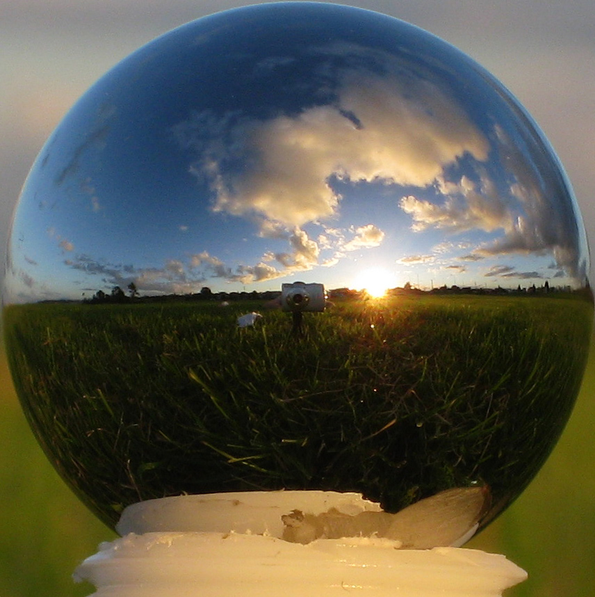

One of my shots - to give you an idea of the source material I'm getting with a
1 inch ball.
Cheers,
Edouard.
Download 'img_8257.jpg' (252 KB)
Preview of image 'img_8257.jpg'
> 1 inch ball.
That's great - much clearer than I've managed so far even with my bigger ball. I
really need to polish it and investigate that focus override... :)
