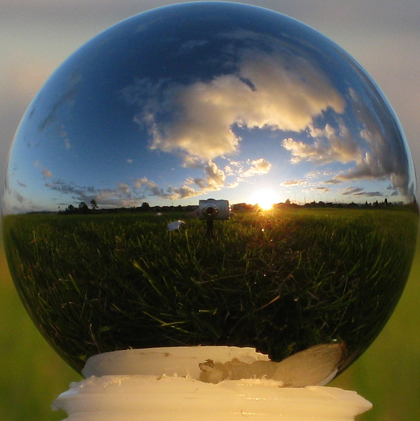

One of my shots - to give you an idea of the source material I'm getting with a
1 inch ball.
Cheers,
Edouard.
Download 'img_8257.jpg' (252 KB)
Preview of image 'img_8257.jpg'
> 1 inch ball.
That's great - much clearer than I've managed so far even with my bigger ball. I
really need to polish it and investigate that focus override... :)
