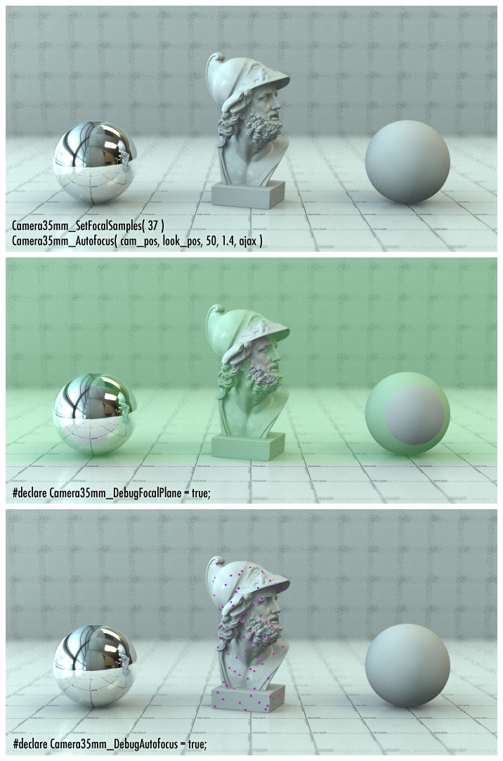

Camera35mm_DebugFocalPlane
    Draws a partially transparent plane through the focal plane.
Camera35mm_DebugAutofocus
    Draws spheres at every position where an autofocus sample
    hit the object being focused on.
    The sphere are purple, except for the one choosen to focus on,
    which is green.

Autofocus Debug Output:
 Number of hits = 77 (out of 500)
 Autofocus tightness = 0.70
 Autofocus on = <14.769, 256.538, -37.084> (distance 1263.750mm)
35mm Camera Debug Output:
 Focal Length is 50mm
 Focal Ratio is f/1.4
 Focal Distance is 1259.1mm
 Field of View is 39.6 degrees
 Sensor size is 36mm by 18mm
 Sensor size is 700 by 350 (pixels)
 Circle of confusion is 0.051mm
 Hyperfocal distance is 34772.2mm
 Near Focus is 1216.7mm
 Far Focus is 1304.5mm
 Total distance in focus is 87.80mm
 In front of focal plane 42.37mm (48.3%)
 Behind focal plane 45.43mm (51.7%)
Focal Blur Debug Output:
 Focal blur samples is 37
 Focal blur variance is (Default)
 Focal blur confidence is (Default)
Download 'camera35mm_macros.jpg' (226 KB)
Preview of image 'camera35mm_macros.jpg'

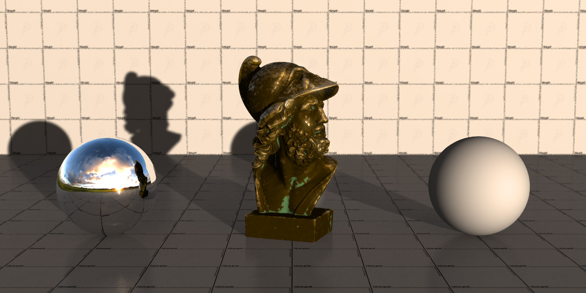

Just playing with the same basic test scene:
Changed to a new lightprobe (one I shot a couple of evenings ago). 16 lights
from LightMapGen, plus one hand placed one (the sun).
The ajax bust was processed by Samuel Benge's fastprox macro (with the mesh
patch), and the resulting proximity colour used in a pigment_patten (with some
noise and slope) to select different types of bronze textures.
50mm lens at f/8, with autofocus on the Ajax bust.
Cheers,
Edouard.
Download 'sunset-test-render-2.jpg' (215 KB)
Preview of image 'sunset-test-render-2.jpg'
