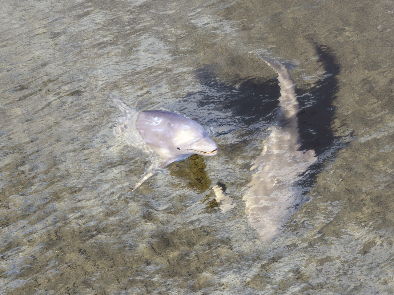

Hi all, I was looking at the bathtub-in-desert scene that Trevor posted the
other day and then I read the water code Thomas had posted and had to try it.
Before I knew it I'd gone off on a tangent and ended up with these two dolphins
swimming around in my own version of the water normal:
#declare Bigripple =
normal {
  waves 1
  frequency 6
  turbulence 0.8
  scale <0.5, 0.2, 0.2>*0.5
  translate -100*z
  rotate -30*y
#declare Smallripple =
normal {
  ripples 1
  frequency 3
  turbulence 0.5
  scale <0.35, 0.25, 0.25>*0.2
  translate 100*z
  rotate -10*z
#declare RippleNorm =
normal {
  average
  normal_map {
    [0.9 Bigripple]
    [0.8 Smallripple]
#declare N_Ripples =
normal {
   average
   normal_map {
      [1 RippleNorm scale 1]
      [1 RippleNorm scale 0.33]
      [1 RippleNorm scale 0.10]
      [0.5 RippleNorm scale 0.05]
      [0.25 granite 0.1 scale 0.01 ]
      [0.125 granite 0.05 scale 0.001 ]
I also ended up averaging two HDR images for the environment map to get the
coloration and mood I was after. I'd never tried that technique before (or even
heard of it actually) but I found it to be very expressive, allowing me to
easily mix & change tonal qualities.
[Dolphin model from Poser 6, textures tweaked by me]
Cheers,
-Rob
Download 'rwmdolphins.jpg' (627 KB)
Preview of image 'rwmdolphins.jpg'
From: Trevor G Quayle
Subject: Re: ...thanks for all the fish
Date: 24 Dec 2008 01:25:01
Message: <web.4951d5ac1d0cd8fbc67b294d0@news.povray.org>
Looks great!
For a suggestion, try setting the waves/ripples as functions and combining them
that way like I have done.  I find that much more flexible and effective.  I
think it may also end up being quicker than using average.  Based on previous
experience (reflection blur to be exact) I think it had come out that when
using average (for normals) each element has to get sampled at each poitn, so
several entries in an averaged normal map caan start to slow the renders down.
This is of advantage for reflection blur, however I don't think it is in this
case.  Either way, I find it more flexible.  Then you can take it and turn the
water into a heightfield rather than normals as well.
I would also suggests adding ripples propogating from the dolphin surfacing.
You could probably get away with a circular or elliptical ripple, use the
cylidrical map.  You need to add two levels to this ripple map.  One that
defines the dissipation of the ripples so that they decrease from maximum at
the dolphin to zero some distance from the dolphin (use poly_wave to control
the falloff of the ripples if you don't want it linear).  The inner level
creates the actual ripples.  Use the cylindrical pattern again but with
sine_wave and a frequency that matches the ripple spacing you want.  You can
even add light turbulence to it so it isn't perfectly regular.
Example:
#declare Ripple= //ripple normal map
  normal {
    cylindrical
    normal_map{
      [0.0 rgb 1]
      [1.0 cylindrical frequency FREQ sine_wave]  //set frequency to how close
you want the ripples
    scale 50  //scale to the size you want
    translate<-9.6288,-21.3782,0>  //translate to the location you want
    poly_wave 6  //controls the falloff rate, higher means faster
-tgq

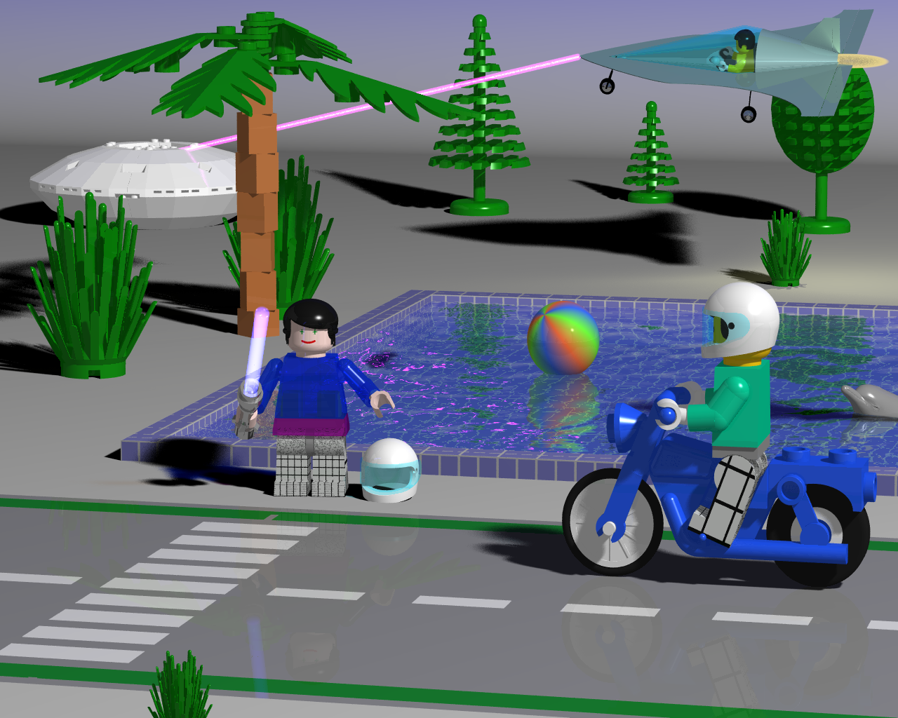

From: alphaQuad
Date: 26 Dec 2008 12:20:01
Message: <web.495511511d0cd8fb1301794d0@news.povray.org>
Free dolphin for the texture geniuses.
http://www.3dnuts.com/models.shtml
Takes 2 minutes to access with poseRay.
4 models in the 3ds file, 2 are dolphins.
Dolphin7 is the first one @ 500kb.
Download 'lego_pool_04e.png' (683 KB)
Preview of image 'lego_pool_04e.png'
