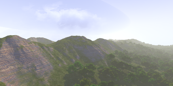

So I'm continuing on my acquaintance with media.  I have this scene where I have
a large sphere with sparse media which acts as atmosphere.  Then, I add an oval
which contains much denser media in order to make a cloud (which is within the
large sphere, of course).  I'm happy with the results of either media when used
independently, but in this picture you can clearly see the outline of the oval,
as if the oval cancels the other media with its own.  Can someone help me with
this?
My current solution is to define everything as a function, and then simply add
the functions together and just have one object with a complicated media
definition.  This works, but with the downside that I have to used more samples
on *everything* rather than just on the clouds which need the greater
definition.  This slows the render considerably.
(The samples are not turned up very high in this render, by the way)
Download 'hftester02.png' (204 KB)
Preview of image 'hftester02.png'
I suspect that it is indeed the problem that interiors are not
generally additive (e.g, what would it mean to have two diffent
iors) and further confusing because except for media most interior
stuff is only calculated for the surface, not volumetric. I didn't
find anything explicit in the documentation, though.
> definition.
Have you tried using the complicated function only in the oval?
If the density of that function matches the density of the simple
atmosphere function at the oval boundary, it might help to get
rid of that effect without requiring the complicated function
for the entire atmosphere. But I suppose the boundary might
still appear due to sampling artefacts.
From: Christian Froeschlin
Subject: Re: Real Clouds with Real Problems
Date: 29 Mar 2008 05:40:54
Message: <47ee1cb6$1@news.povray.org>
I also wondered if you could fake the atmosphere by
calculating the sky blue only in a shell from 2km up,
and the local fog/humidity only in a thin layer over
the ground, and thus reserve some "vacuum" layer for
placing your clouds in.

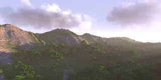

From: Kirk Andrews
Date: 29 Mar 2008 08:30:06
Message: <web.47ee43d891cbe459a5d4a01d0@news.povray.org>
Well, I'm finding that despite the longer render times, using more samples
overall has some distinct advantages, such as the light streaks you get in this
render.  In reality, the media did not have nearly as much effect on the render
time as did the forest, once you add radiosity and AA.  I'm pretty happy with
the results here, although I'd like to change the shape of the clouds a bit and
perhaps add more.  The forest could use some more variety in the vegetation, as
well.

From: Abe
Date: 29 Mar 2008 12:15:01
Message: <web.47ee768991cbe459810d540e0@news.povray.org>
> this?
Nice image.
I have been dealing with the same issue for several years (as I suspect have
many others).
The problem is, roughly, as you described it: minimize the number of samples
where the media density/lighting is uniform and concentrate the sampling where
the media density/lighting is variable. (N.B. You used the expression "sparse
media" which I interpret to mean low density. While a low density can minimize
the visual impact of sampling artifacts, it is actually the instance of a
constant density v. a variable density which allow for an acceptably fewer
number of samples.)
Media parameters allow for the direct control of the number of samples, but not
the sample spacing. Generally speaking, sample spacing is indirectly controlled
by the size of the media container in conjunction with the number of samples.
This is where the idea for using separate and differently sized media
containers for atmosphere and clouds comes in. Unfortunately, as we know,
intersecting media containers become visible in the participating media. I am
guessing it might have to do with additional samples which are initiated when
the ray intersects the additional media containers and/or the manner in which
the sample "results" are combined.
One workaround is as you described it: put everything in one container and use
functions to control the different densities. Another solution (one which I
prefer) is to make a spherical shell for the cloud container, something like
//Camera is located at <0,0,0> "ground level"
#declare cloud_base_altitude=10;
#declare cloud_depth=1;
#declare cloud_shell_radius=1000;
#declare cloud_shell=
difference{
  sphere{<0,0,0>, cloud_shell_radius+cloud_depth}
  sphere{<0,0,0>, cloud_shell_radius}
  hollow
  pigment{color rgbt 1}
  translate -y*(cloud_shell_radius-cloud_base_altitude)
The spherical shell container creates another issue. The distance that the ray
travels when it traverses the shell near the horizon is much longer than when
it traverses the shell directly overhead. In other words, that sampling density
is generally higher overhead and lower at the horizon. Also the orientation of
the sampling ray to the media (cloud) pattern changes. This often manifests
itself in choppy or shelf like artifacts in the clouds near the horizon. In
order to address _that_ issue, I've been moderately successful in defining a y
oriented cylindrical based pigment pattern which transitions from a high
contrast cloud pattern directly overhead through progressively lower contrasts,
to a uniform media at the horizon. This also seems take advantage of the method
3 sub sampling which will increase near the horizon where you need it.
Anyway, if you're a povray diehard like me, keep it up. You'll come up with a
solution which will work for you. Otherwise Terragen 2 is looking pretty good.
Abe
Afterthought: I realize that I've used the word "density" in both its general
sense and its SDL sense. I hope it's not too confusing the way I've phrased
things.

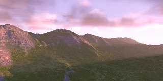

From: Kirk Andrews
Date: 29 Mar 2008 13:05:01
Message: <web.47ee83c191cbe459b555cae70@news.povray.org>
Well, here's some more tests.  This one was done with samples at 20 and took
about 36 min.  As you can see, there's no AA on this one, though.  Even at 20,
you can still see that "shelving".
I suppose one could cut up your atmosphere into segments, and have something
like:
intersection {
  sphere {0, AtmosphereSize}
  box {<-Size,0,-Size>, <Size, CloudAlt, Size>}
  ...samples 1,1...
  density {MediaFunction(x,y,z)}  //all using the same function
intersection {
  box {<-Size,CloudAlt,-Size>, <Size, CloudAlt+CloudDepth, Size>}
  ...samples 20,20...
But I suspect that in some way the tangent surfaces would show up.  Also, I'm
finding that changing the samples tends to affect the apparent density.  So the
density of the background might be obviously different in the two boxes.
Download 'lightinthevalley02.png' (383 KB)
Preview of image 'lightinthevalley02.png'
From: Roman Reiner
Date: 30 Mar 2008 09:30:03
Message: <web.47efa2f691cbe4597c12433d0@news.povray.org>
Are you aware that you can have multiple media blocks in the same interior? That
way the medias will add up. So the solution should be to simply copy the media
definition of the sky into the interior block of the clouds container object as
well.
Regards Roman
> independently, but in this picture you can clearly see the outline of the oval...
Like others here, I've been grappling with this conundrum for a long time. Based
on *lots* of tests and experiments, I've come to some conclusions:
1) When there are two media objects, one inside the other (like your cloud oval
inside your atmosphere), the larger enclosing sphere's media samples value
completely overrides the smaller sphere's (and, I believe, its method and
intervals as well.) You can test this by giving your cloud media samples 1000,
and your atmosphere samples 1.  It will render lightning fast--and look
terrible! Reverse the order, and BOTH spheres' media take on samples 1000. Or
more generally, both spheres' medias seem to be treated as one, samples-wise.
This has caused me grief in the past, when I actually *wanted* the smaller
sphere to have a smaller samples count, just for the look.  But it can't be
done, unfortunately. As others have mentioned, the best (and only?) way of
eliminating or minimizing the small sphere's "visibility" is to keep pumping up
the samples count--in the larger enclosing sphere's media.
