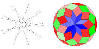

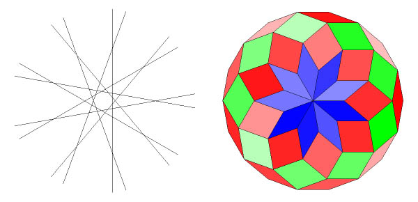

Here is an image showing, on the left, a line arrangment, on the right, its
generalized-dual zonogonal tiling. Here, n=9. Since there no more than two
lines ever intersect in one point, the only zonogons are rhombs.
Notice that in the line arrangement, there is a central hollow area bounded by
nine segments. In the tiling, there is a central vertex, where nine edges meet.
The right-most point of intersection in the line arrangement corresponds to the
right-most rhomb in the tiling.
There are thirty-six points of intersection in the arrangement, and thirty-six
rhombs in the tiling.
There are eighteen unbounded regions between lines around the arrangement; and
eighteen vertices are on the boundary of the tiling.
