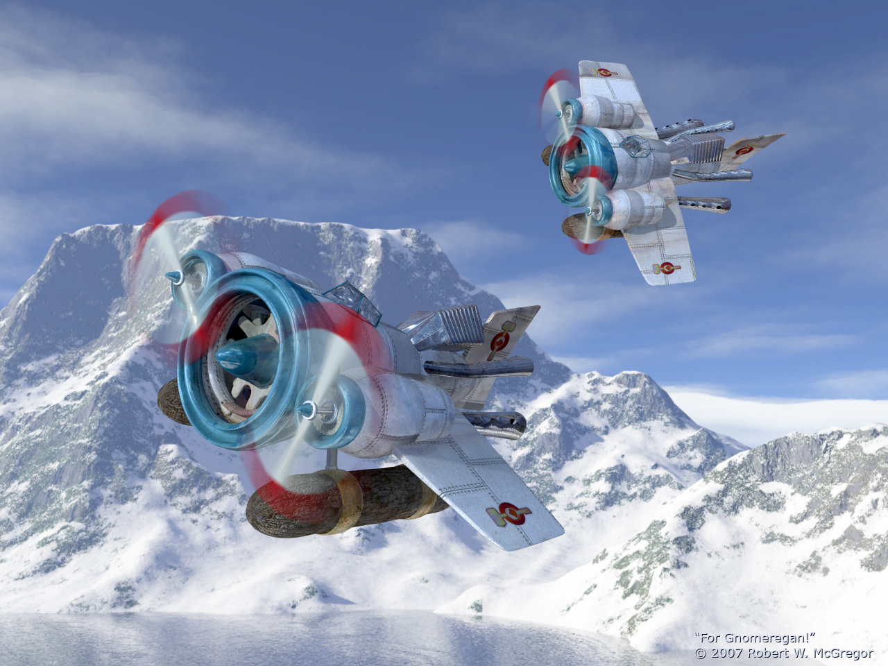

Hello everybody,
Over the last several days I've been working on this image of Gnomish flying
machines for the current TC-RTC stills round.
I still need to add smoke trails and a few other things, and I thought I had 2
more weeks to finish this, but I discovered this morning that the competition
now closes 2 weeks before the end of the month. So, this is the version I'm
forced to enter - thought I'd share it and get some feedback.
Rob

This looks really good so far!
One note for you: how are you doing the motion blur?  Are you doing "real"
motion blur or is it faked using transparent discs or something?  For the near
plane on the furthest propeller, there is some specular reflection on it, I
would expect to see this 'smeared' across the motion blurred areas as well.
(as an aside, true motion blur would not leave a single static oject amongst
the motion blurred ones unless a flash or someting is used to highlight a
particular instant, but we often see it this way or assume it should be, so you
can take a little artistic license)
-tgq

Hi !
Your image is very nice : BRAVO !
The only little "bugs" I can see are :
- the fueltank texture at their ends
- the shadow of the wing's rivets : it is on the wrong side on the
fore-ground wing ... maybe using a bumpmap could correct this ?
Bravo again !

Impressive, I agree!
> particular instant
I do not fully agree. The angle that the object make compared to the eye
and the light source vary through the rotation, and there might be
singularity points. An obvious example would be a rotating mirror in a
dark area with a small lighted scene nearby. The rotating mirror would
show up as some blurred grayish form, but for the angle it exactly
project the lighted scene reflect to the camera eye. So the result would
be some blurred grayish form plus a very sharp image of the scene.
For a propeller, you'll see easily see that in real life under any
average sun light.
	Yannick

From: Rob M
Subject: Re: Aeroplanes
Date: 17 Dec 2007 21:25:01
Message: <web.47672e6ccf321239bd1b3ad10@news.povray.org>
Florian Brucker <tor### [at] torfboldcom> wrote:
> Nice work, Rob! You did a great job at the overall design, looks very
> steampunk-ish to me.
Thanks Florian - steampunk-esque I'd say...actually inspired by my passion for
both povray and World of Warcraft.
Backstory: The eccentric, often-brilliant Gnomes have an obsession for
developing radical new technologies and constructing marvels of mind-bending
engineering. Outcast from their wondrous techno-city of Gnomeregan the Gnomes
now share the resources of Dun Morogh's frozen peaks with their Dwarven
cousins. Although the dwarves of Ironforge also have a propensity for
technology and engineering, it is the gnomes who provide the critical,
visionary designs for most of the Dwarves' weapons and military vehicles.
This Image: Two Gnomish flyboys test their new experimental flying machines over
the frozen wilds of Dun Morogh... "For Gnomeregan!"
> I'd like to hear some details on the modelling (CSG, mesh, 3rd party
> programs, etc.) if you don't mind :)
The design of these gnomish monoplanes was inspired by the Xiggs Fuselighter
flying machine as seen in the World of Warcraft quest "Signal for Pickup" in
Azshara (although I was tempted to use the standard Gnomeregan biplane design).
You can see the original at this URL:
http://wow.allakhazam.com/db/mob.html?wmob=8446&locale=enUS;source=live
The aeroplane parts were modeled mostly with Wings3d, with some POV-SDL CSG
thrown in. I exported the Wings3d objects to OBJ and then converted them to
Mesh2 using PoseRay. I wrote a couple of POV-SDL macros that assemble the parts
into unique aeroplanes by allowing random variations in the texturing. During
assembly each part is textured individually with layered proceduralized image
maps and straight procedural textures all composited on-the-fly (no pun
intended).
Since I was short on time for this piece I pre-rendered the mountains, lake, and
sky that are visible in the background using Terragen, and then projected that
as an imagemap onto a background plane. For global ambience and reflection
mapping I used a simulated HDRI light dome with a spherical map of the cloudy
sky and snowy mountains on an ambient sphere scaled to 1000 units.
I grabbed the ubiquitous hammer and mountain symbol of Ironforge directly from a
World of Warcraft screenshot (WoW sidebar: My main toon is Sgt.Jhary, level 70
holy priest, Etherion Guild, Llane Realm, Alliance) and image mapped it to the
wings and tails of the planes as a TGA with alpha channel.
The final bit was to make the props look convincingly spinning/blurred so I
switched over from POV-Ray 3.6 to MegaPov 1.2 for the final render using the
motion_blur feature. There's a simple 2 bounce radiosity setting in the final
render, again because I ran out of time... I thought I had 2 more weeks, and
was planning to have media smoke trails and a few other goodies but just found
out the competition now ends 14 days before the end of the month, so... well
here it is, as is...
"There is no spoon."

Really beautiful aeroplanes.  What a great design (and execution.) Lots of
attention to detail.
Nice one!
