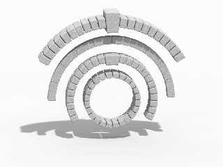

Afternoon, all.
Not posted for a while; my laptops were stolen last month so raytracing's
been off the menu for a bit (unless I do it by hand - eek!).
I was doodling a few days ago during a lazy afternoon at work, and came up
with a half-decent archway macro. It builds arches with or without
keystones from curved, smooth-edged bricks using CSG. Arches are defined by
angle, number of bricks and inner / outer radius, centred on the origin.
Bricks can be spaced out or touching. Here's an example image with four
concentric arches of varying shape; it took ages to render but that's
mainly because of the radiosity and normals. I'll post source if anybody's
interested.
I was interested to note that when I hand-bounded the intersection shapes,
rendering sped up by about 4x!
Bill

Nice! This will be quite useful for a large number of people.
Thanks
> Bill
I wrote an 'archtile' macro to create the same rounded tile shape (but not
the entire arch), and I found the same thing.  Unbounded tiles took ages to

Very cool, They look great.

VERY cool, and useful.  Good to see that the loss of the laptops hasn't kept
you down! Always a pleasure to see what you're up to.

Sounds like there's some interest. I'll tidy it up and post it in a bit!
Bill

Right, here's the macro.
There has to be an even number of bricks in the arch, even without a
keystone. If the edge radius is zero, the macro leaves out all the edge
curved shapes to save memory, etc. Enjoy!
