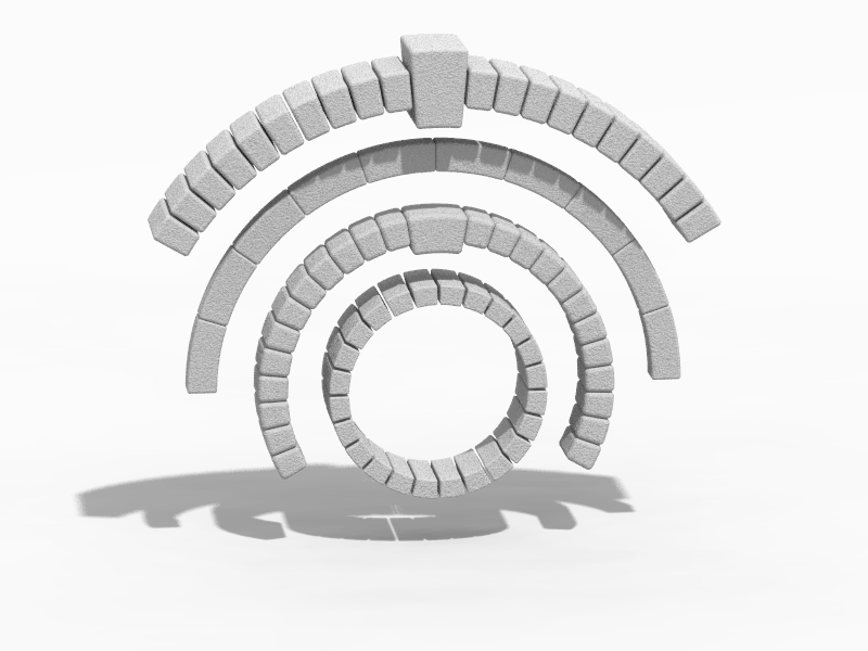

Afternoon, all.
Not posted for a while; my laptops were stolen last month so raytracing's
been off the menu for a bit (unless I do it by hand - eek!).
I was doodling a few days ago during a lazy afternoon at work, and came up
with a half-decent archway macro. It builds arches with or without
keystones from curved, smooth-edged bricks using CSG. Arches are defined by
angle, number of bricks and inner / outer radius, centred on the origin.
Bricks can be spaced out or touching. Here's an example image with four
concentric arches of varying shape; it took ages to render but that's
mainly because of the radiosity and normals. I'll post source if anybody's
interested.
I was interested to note that when I hand-bounded the intersection shapes,
rendering sped up by about 4x!
Bill
Download 'archbrick.png' (153 KB)
Preview of image 'archbrick.png'

Nice! This will be quite useful for a large number of people.
Thanks
> Bill
I wrote an 'archtile' macro to create the same rounded tile shape (but not
the entire arch), and I found the same thing.  Unbounded tiles took ages to
