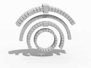

I was doodling a few days ago during a lazy afternoon at work, and came up
with a half-decent archway macro. It builds arches with or without
keystones from curved, smooth-edged bricks using CSG. Arches are defined by
angle, number of bricks and inner / outer radius, centred on the origin.
Bricks can be spaced out or touching. Here's an example image with four
concentric arches of varying shape; it took ages to render but that's
mainly because of the radiosity and normals. I'll post source if anybody's
interested.
I was interested to note that when I hand-bounded the intersection shapes,
rendering sped up by about 4x!
Bill
> Bill
I wrote an 'archtile' macro to create the same rounded tile shape (but not
the entire arch), and I found the same thing.  Unbounded tiles took ages to

From: Bill Pragnell
Subject: Re: Archway macro
Date: 17 Aug 2006 05:50:00
Message: <web.44e43abb4f0e252c731f01d10@news.povray.org>
Right, here's the macro.
There has to be an even number of bricks in the arch, even without a
keystone. If the edge radius is zero, the macro leaves out all the edge
curved shapes to save memory, etc. Enjoy!
