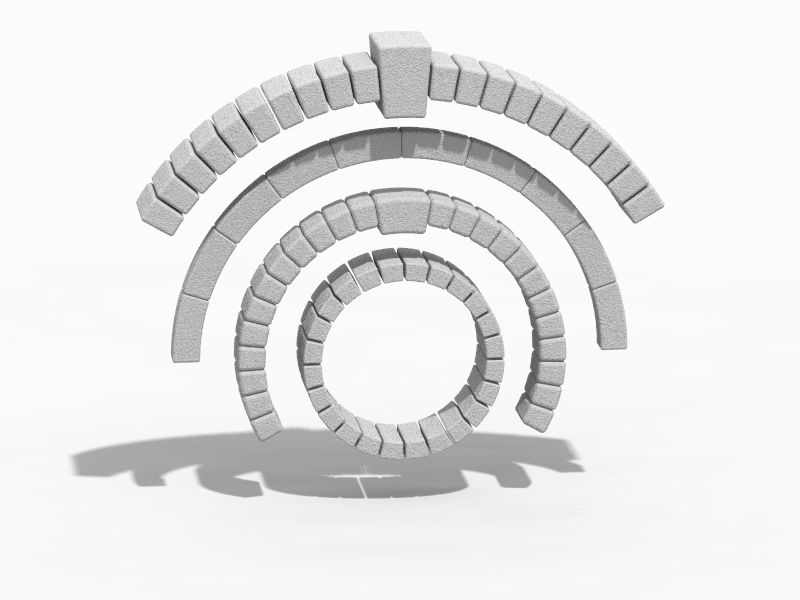

Afternoon, all.
Not posted for a while; my laptops were stolen last month so raytracing's
been off the menu for a bit (unless I do it by hand - eek!).
I was doodling a few days ago during a lazy afternoon at work, and came up
with a half-decent archway macro. It builds arches with or without
keystones from curved, smooth-edged bricks using CSG. Arches are defined by
angle, number of bricks and inner / outer radius, centred on the origin.
Bricks can be spaced out or touching. Here's an example image with four
concentric arches of varying shape; it took ages to render but that's
mainly because of the radiosity and normals. I'll post source if anybody's
interested.
I was interested to note that when I hand-bounded the intersection shapes,
rendering sped up by about 4x!
Bill
Download 'archbrick.png' (153 KB)
Preview of image 'archbrick.png'

Right, here's the macro.
There has to be an even number of bricks in the arch, even without a
keystone. If the edge radius is zero, the macro leaves out all the edge
curved shapes to save memory, etc. Enjoy!
// curved-brick macro. creates bricks curved in x-z plane.
// rin = inner radius
// rout = outer radius
// redge = edge radius
// depf = thickness of brick perpendicular to curvature plane
// angl = angular size of brick
#macro ArcBrick(rin, rout, redge, depf, angl)
  #local h = depf/2;
  #local hin = depf/2-redge;
  #local xout = rout*sin(radians(angl/2));
  #local yin = rin*cos(radians(angl/2));
  intersection {
    union {
      difference {
        cylinder { <0, h, 0>, <0, -h, 0>, rout-redge }
        cylinder { <0, depf, 0>, <0, -depf, 0>, rin+redge } }
      difference {
        cylinder { <0, hin, 0>, <0, -hin, 0>, rout }
        cylinder { <0, depf, 0>, <0, -depf, 0>, rin } }
      #if (redge > 0)
        torus { rin+redge, redge translate <0, hin, 0> }
        torus { rin+redge, redge translate <0, -hin, 0> }
        torus { rout-redge, redge translate <0, hin, 0> }
        torus { rout-redge, redge translate <0, -hin, 0> }
      #end }
    plane { <-1, 0, 0>, -redge rotate <0, -angl/2, 0> }
    plane { <1, 0, 0>, -redge rotate <0, angl/2, 0> }
    #if (angl < 180)
      bounded_by { box { <-xout, -depf, yin>, <xout, depf, rout> } }
    #end }
  intersection {
    difference {
      cylinder { <0, hin, 0>, <0, -hin, 0>, rout-redge }
    plane { <-1, 0, 0>, 0 rotate <0, -angl/2, 0> }
    plane { <1, 0, 0>, 0 rotate <0, angl/2, 0> }
    #if (angl < 180)
    #end }
  #if (redge > 0)
    // corners
    sphere { <-redge, hin, rin+redge>, redge rotate <0, angl/2, 0> }
    sphere { <-redge, -hin, rin+redge>, redge rotate <0, angl/2, 0> }
    sphere { <-redge, hin, rout-redge>, redge rotate <0, angl/2, 0> }
    sphere { <-redge, -hin, rout-redge>, redge rotate <0, angl/2, 0> }
    sphere { <redge, hin, rin+redge>, redge rotate <0, -angl/2, 0> }
    sphere { <redge, -hin, rin+redge>, redge rotate <0, -angl/2, 0> }
    sphere { <redge, hin, rout-redge>, redge rotate <0, -angl/2, 0> }
    sphere { <redge, -hin, rout-redge>, redge rotate <0, -angl/2, 0> }
    // vertical edges
    cylinder { <-redge, -hin, rin+redge>, <-redge, hin, rin+redge>, redge
    cylinder { <redge, -hin, rin+redge>, <redge, hin, rin+redge>, redge
    cylinder { <-redge, -hin, rout-redge>, <-redge, hin, rout-redge>, redge
    cylinder { <redge, -hin, rout-redge>, <redge, hin, rout-redge>, redge
    // in-plane edges
    cylinder { <-redge, hin, rin+redge>, <-redge, hin, rout-redge>, redge
    cylinder { <-redge, -hin, rin+redge>, <-redge, -hin, rout-redge>, redge
    cylinder { <redge, hin, rin+redge>, <redge, hin, rout-redge>, redge
    cylinder { <redge, -hin, rin+redge>, <redge, -hin, rout-redge>, redge
  #end
#end
// archway macro. creates arches in x-y plane.
// Total_Angle = total angular size of arch
// Keystone_Angle = angular size of keystone
// nBricks = number of non-keystone bricks in arch (must be even)
// Padding = spacing between bricks as a fraction of total brick size
// rInner = inner radius
// rOuter = outer radius
// kInner = keystone inner radius
// kOuter = keystone outer radius
// Thickness = thickness of arch
// rEdge = edge radius
#macro Arch(Total_Angle, Keystone_Angle, nBricks, Padding, rInner, rOuter,
kInner, kOuter, Thickness, rEdge)
  #local Brick_Angle = (Total_Angle - Keystone_Angle)/nBricks;
  #local ang = -(Total_Angle/2 - Brick_Angle/2);
  #local n = 1;
  #while (n <= nBricks/2)
    union {
      ArcBrick(rInner, rOuter, rEdge, Thickness, (1-Padding/2)*Brick_Angle)
      rotate <-90, 0, 0> rotate <0, 0, ang> }
    #local n = n + 1;
    #local ang = ang + Brick_Angle;
  #end
  #if (Keystone_Angle > 0)
    union {
      ArcBrick(kInner, kOuter, rEdge, Thickness,
               Keystone_Angle-Brick_Angle*Padding/2)
      rotate <-90, 0, 0> }
  #end
  #local ang = Keystone_Angle/2 + Brick_Angle/2;
  #while (n <= nBricks)
    union {
    #local n = n + 1;
  #end
#end
// example arch:
union {
  Arch(240, 20, 24, 0.05, 0.75, 0.9, 0.7, 0.9, 0.3, 0.025)
  texture { Stone } }
Bill
