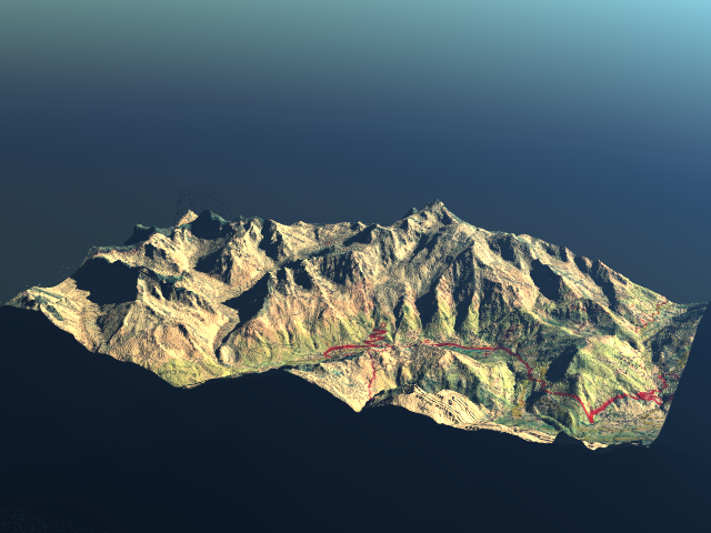

Hi there
this is a small test using a 30mx30m elevation grid on which I mapped the
corresponding roadmap. This is the Mont Blanc area (the winding road in red
above Chamonix is the one going to the tunnel entrance).
Maybe I'll try to add some small clouds later on...
Sylvain

From: Oleguer Vilella
Subject: Re: Mont Blanc
Date: 16 Jun 2006 13:51:16
Message: <4492ef94$1@news.povray.org>
Where's that mountain?

From: M a r c
Date: 16 Jun 2006 14:11:10
Message: <4492f43e@news.povray.org>
news: 4492ef94$1@news.povray.org...
in the Alps on the border between Italy and France
Marc

From: kurtz le pirate
Date: 17 Jun 2006 05:40:24
Message: <kurtzlepirate-FEC5CA.11402517062006@news.povray.org>
In article <web.4492702be4ed7dda9e4a59f60@news.povray.org>,
 "Sylvain" <rem### [at] lapostenet> wrote:
> Hi there
> Sylvain
> [Image]
good test ! but, where do you find this kind of maps ?
klp
