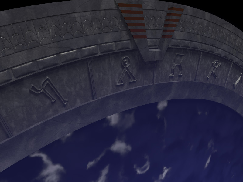

Ok, so I'm Sci-Fi fan.  Here's a WIP of the stargate.  I still have some
work to do on the chevrons, but I'd like to get some advice on making it
look more "real".  I'm using layered textures, but it seems like there's
something missing.  Maybe it's the lighting?  Any suggestions are
appreciated.  (BTW, the water looks cool animated).
Mike
Download 'stargate_01a.jpg' (154 KB)
Preview of image 'stargate_01a.jpg'

Good modeling! How did you make those symbols? font object with stargate
font or hand modeled?
Lighting seems a bit simple i have to agree. but i'm not very good in
lighting either so i'll pass the question to more experienced persons.
work on the textures is definitely recommendable. it just looks to... hmm
procedual? i think when one is able to recognize the pattern used (agate
right? ;)) then the textures need work.
Regards Roman
> Mike
My thoughts for whats they're worth.
The "Fracture" lines or cracks , need to be tightened up, thay appear to be
smudgey.  If this cracking is from aging then I think they need to be
stronger, sharper edges and a stronger-darker color.
I cent see if the top image using area_lights but is doesn't look light it.
Sticking in high definition area_light(s) is a good way of increasing  the
realism.
Another lighting tip, is to have secondary lighting . It rare that there is
a single light source in real life.  The secondary lights should be weaker
than you main source but still able to cast shadows.
It might benefit from using slightly differnt textures on the differn't
parts of the structure.  You often find that what is accurate to life, does
not actually look right in a picture.

Great modeling, looks awesome. Not sure what you mean by something missing.
I'd say it looks a little plastic and you need a more metal look. Tweak the
lighting a little.

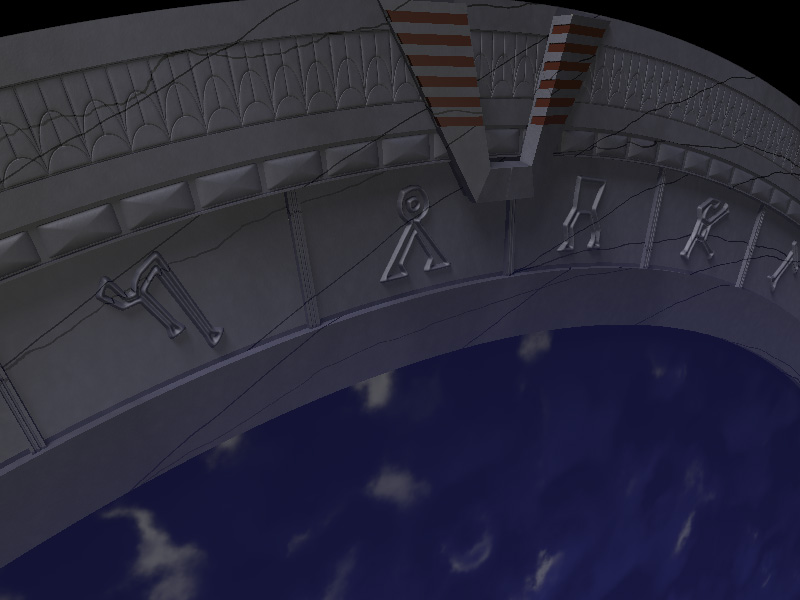

Thanks!  I started with a font object, but it didn't look right.  So, I used
POVRay to make a b/w image for each glyph, then blurred it a bit and made a
height field with each one.
> Regards Roman
Well, it is a _bit_ more complex than that, but all the layers I made didn't
seem to help much.  See below for the code, and maybe you can give me some
suggestions?
Ok, I tried to fix that.
>realism.
I added area lights and a secondary light.  I think it helped a lot!
Here's the texture code.  It's supposed to be some kind of stone. Any
suggestions?

Apart from those cracks the texture seems just like plain gray to me. So
raising the contrast of those patterns at least during the w.i.p. phase.
Don't be afraid of going over the top as lowering contrast is always easier
than raising it afterwards. Higher contrasted patterns do also have the
advantage that changes are easier to recognize and therefore less time
consuming.
Raising contrast does mean:
a) (trivial) increase there relative brightness
b) more sophisticated ;) change there colors (less gray). A pattern of
complementary colors look better than simple gray mostly.
and c) as you've already done here and there
use something like
[0.0 Color1]
[0.4 Color1]
[0.6 Color2]
[1.0 Color2]
instead of just
[0.0 Color1]
[1.0 Color2]
at your color fades.
Hope this helps.
One thing about those cracks. I couldn't find such on the 'original'
stargate (e.g.
http://pressthebuttons.typepad.com/photos/uncategorized/chevron.jpg). is
this variance wanted?
Regards Roman

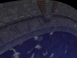

Well, take a look!  I think the texture is close enough that I can get on
with the rest of the modelling.  Thanks a bunch!
> stargate (e.g.
> Regards Roman
Actually, if you look closely, you can see them (especially at the uppermost
part of the chevron).  But they are much less prominant than in my first
attempt, so I toned it down a bit.
Download 'stargate_04.jpg' (96 KB)
Preview of image 'stargate_04.jpg'

The texture looks pretty good to me - perhaps just a bit "washed out".
One thing I was noticing as I watched the opening credits of a recorded
episode, though, is that your stargate shows the outline of the symbols
raised, but the one in the show has the entire character raised (ie, not
hollow - not a raised outline but the whole character is raised).
Jim
