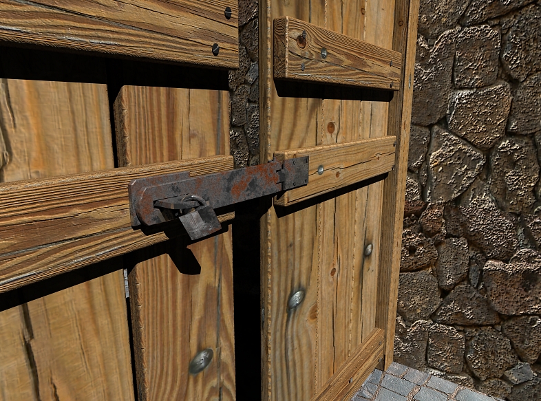

Hi everybody, I'm trying with textures. This is the end test:)
Hasan
Download 'kilit2.jpg' (433 KB)

Love the knotholes... - warps?

No warps, its nor procedural, image maps with bumps.
Only Lock's texture is procedural.

Very impressive, in my opinion. Not quite perfect, but I can't put my
finger on why...

Looks great, the textures are just lovely.
But while we have our fingers out, there's a couple of compositions
things I'll put my finger on:
1. The two doors should come a lot closer to meeting as should the
    vertical timbers
2. There's (possibly deliberate) evenly-spaced filleting down the
    vertical timbers
3. The lock isn't held to the door in any way that will stop intrusion
	3a. The RHS needs to have bolts or hotrivet through the timber
	    - round heads on the outside (and inside if they're
	    hotrivets and the long part of the hinge normally sits over
	    the top of that part making it even harder to unbolt.
	3b. If you don't fold it over then the hinge-pin in the door
	    needs to be away from the gap between the doors so that all
	    that is exposed to the other side is flat iron
4. The doors need diagonal cross-bracing .. this holds the door up and
    will stop it sagging
(If you're going for the look of low-tech (despite the padlock) then
you'll need to make the doors sag a fair bit and increase the size of
screws and bolt to the point where they could be hand-forged)
If you don't hate me right now, care to share that timber texture?
Cheers!

Rick ,
You will almost write the door story.  I'm very hating you:)
this is a joke.
I have not thought to make a architectural door.
 I have wanted to realistic overlay to the timbers.
This wood texture :
http://www.monitorstudios.com/bcloward/textures/wood_boards.jpg
Regards.
Hasan

The problem with the image is that the shadows/light on the stone image-map
is from the wrong side... inverse the stone image so that the light is
coming from the right instead of the left and it should look more
realistic.
