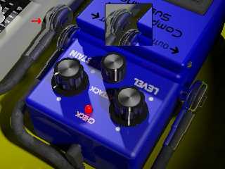

Hi folks.  The floor of the gap between these two boxes is in total
darkness, so I'm using radiosity to bring it out.  The default
radiosity settings produce the inset image, with obvious horizontal
artifacts.

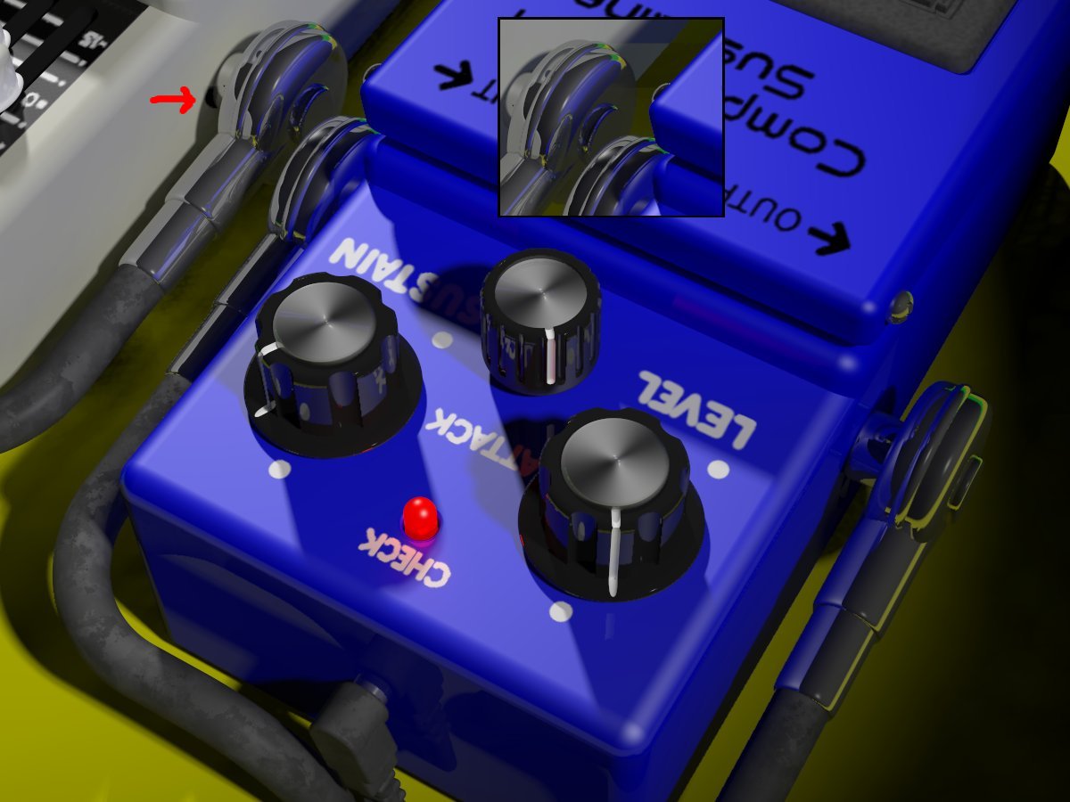

After a few renders I ended up with
 count 80 nearest_count 8 error_bound 0.1
 pretrace_end 0.02 adc_bailout 0.01
....which rendered the attached image in 6h45m.  It still isn't good:
it looks like my graphic equaliser is leaking coal dust.  And it takes
five times as long to render as radiosity{}.
I've had about enough of the tweak/render loop, so I'm turning to you
for advice.
Also, the finer settings introduced the black splotch arrowed.  Ummm, ?
Actually, I'm not too cut up about the final result - these models are
part of a much larger project and will not be viewed too closely, and
certainly not on a green and yellow chequered plane.  That's why I'm
not fixing the image maps or the cable texture.  However I would like
to understand radiosity a little better, so I'm looking forward to
your suggestions.

> what about increasing the count?
At your suggestion I tried 200 overnight (11 hours), and the image is about
the same.  The splotchiness has tighter edges :-)  Not to worry, it's not a
final.
Thanks for the suggestion.

Increasing error_bound usualy lead to smoother results. You can try something around
0.4 to 0.8. Low
values also take more time and memory that larger ones.
When using low error_bound value, you frequently need to proportionaly increase the
count, you may
need a value higher than 800.
Lowering low_error_factor result in more samples at the end of the pretrace, it can
improve your
results.
Lowering pretrace_end can, in some instances, provide higher quality.

Usually black spots with radiosity around reflective objects means that you
need to decrease the adc_bailout and/or increase the max_trace_level.
-Nathan
Did you try increasing max_trace_level?  In images including reflective
objects, I often have to double the max_trace_level when I use radiosity.

1) This is a beautiful image and I would love to see a zoomed-out
version.
2) Touch up the image in photoshop or gimp or some other paint
program to fix any sploches.
