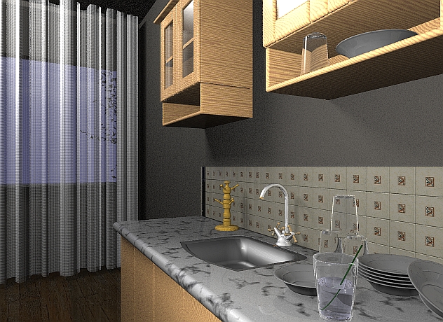

Stefan, I was changed lights. ok.
Alain <ele### [at] netscapenet> wrote:
> Using area_light will increase the realistic aspect by bluring the shadows. Using
adaptive is a
> must, it realy does improve rendering speed. Optimum aray size are 5, 9, 17, 33, 65,
129,... Start
> with adaptive 0 and increase if you get artefacts: light where there sould be none,
shadow where
> there should be light.
> Using more than one light may also help.
> You can try radiosity, just add radiosity{} in the #glabal_settings block to enable
radiosity with
> all default values. You can then try different tweaks, look at the documentation.
> Alain
> I used to have an open mind but my brains kept falling out.
Alain, I used in the new version, one area light and two point light without
shadow. I increased resolution (640x480, Antialias_Threshold=0.1) This
render quality better then previous. I dont use Radiosity, becouse it will
be slowness. This render time : 3h 37 m. I will post two images : The firt
is natural . The second is applied sharpen (image editor). Can we make with
the povray render like second..
Hasan...

Well, if you turned down (or off) antialiasing that would do it, but I am
not sure why you would want it to look like that. I like the first one much
better.

Absolutely much better :)
Stefan
